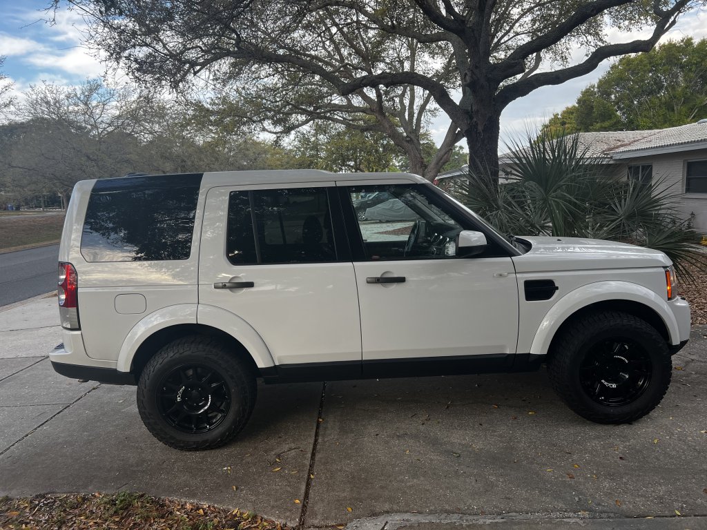

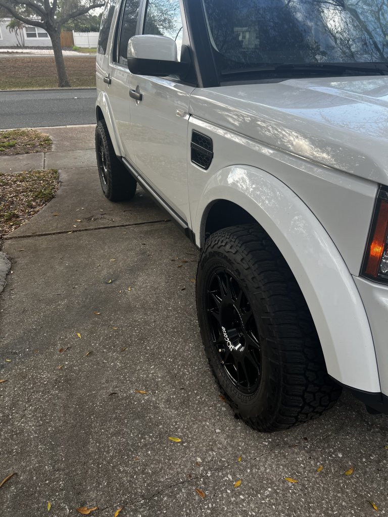

I just got a set of Evo's on 265/65/18 Falken Wildpeaks and can confirm they fit without any mods, fully locked in forward and reverse. I tried using 30mm spacers too but they rubbed like hell so I took them off until I get the courage to cut the frame and wheel wells. Just got them balanced and aligned for a +1.5" lift and loving them so far.
