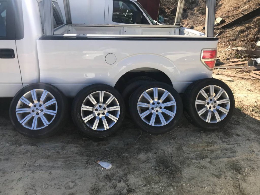

Does anyone have information on cross capability of 20" Land Rover OEM wheels that work on the LR4?
I found a set of L322 wheels on Craigslist and I'm thinking of using them with 255-55-20 tires for a 2012 LR4 we just got. The LR4 needs new tires but has the 19" wheels. I'll get the wheels powder'd before install (I'm thinking a dark grey to go with the Aintree Green paint).
