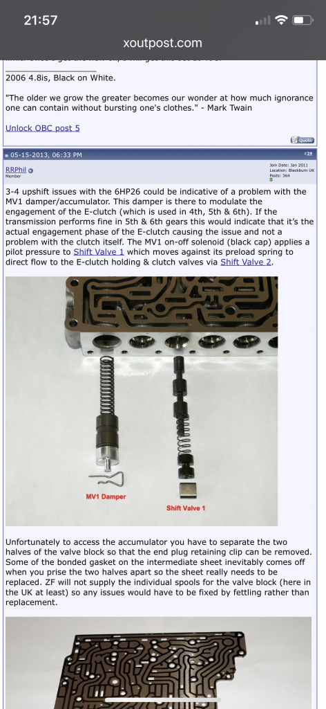

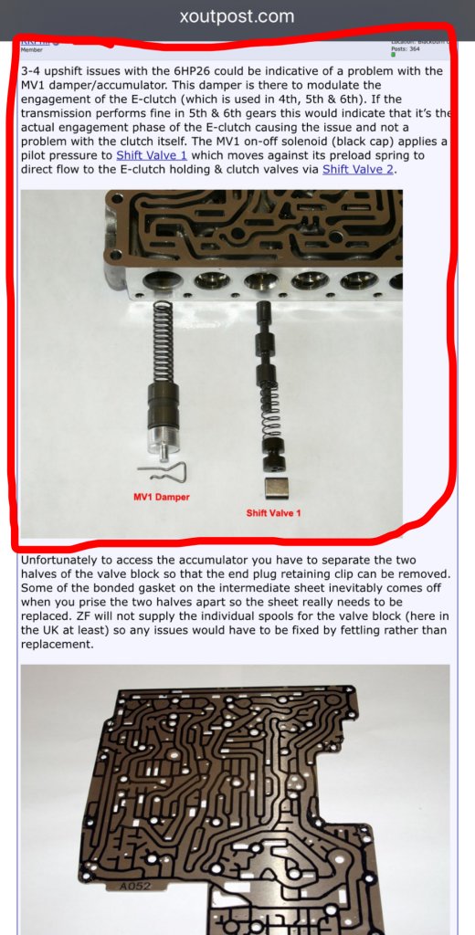

you know I did think about that, I think it could be possibly out of the tranny due to the fact that when I went to have my transmission fixed for my ever lasting 3-4th upshift problem, they said the tranny fluid was half a quart low and it had just been filled up last month. Half a quart isn’t that low but my engine oil didn’t drop a level at all. Whenever the “transmission fault” amber comes up on my dash I’ll have them check the fluid see if it’s a little lower then propose the idea and have them change out the e-clutch engagement valve aka mv1 damper as well as shift valve1 and let you guys know. Incase your wondering I’ll link the article down below that I read on this from a former BMW owner with a zf6hp26.
