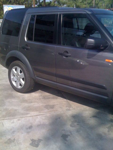

So I just purchased a 2006 HSE yesterday and love it, except for the molding on the doors. I haven't seen many LR3s with this molding, and I much prefer the look without it.
I was wondering if anyone had experience removing these. I am thinking it is as simple as double sided tape, but I want to verify first before getting in there. So trim adhesive remover and a rubber wedge of some sort was how I was going to go about removing it.
I also wanted to know if the paint was going to be uniform on the door. I don't want to take it off and have the outline of where it had been visible.
This is on a Bonatti Grey LR3. Any thoughts?

I'm kinda in the same boat. I'm afraid of taking them off and not being the same shade, and having a hard time getting the adhesive off. As far as taking the molding off try a long piece of dental floss and working it back and forth , or a guitar string maybe.

Held on w/ double sided tape. Unless there is shoddy paint underneath, a good bit of floss, followed by goof-off and then wax and polsih for good measure and you should be done.
LR pulled these form sale about 6 mths back, due to adhesive failures. Myabe if you wait long enough, they will remove themselves!

I have those, and it's saved me more than once in parking lots. Yours seems to be mounted lower than specification, though. Yes, they are just double stick tape and are removed like any vehicle sticky badging. A hot day and dental floss is a good start... and just peel it off. Then clean up using your favorite goo remover.

Anyhow, the other thing you have to consider here is whether the paint NOT under the molding has faded from UV exposure. It is a risk...

That is my biggest concern. I guess worst case scenario is I put them back on. Now I have to go ask the wife if she has the same dislike for them as I do, as it is her car.

I've been thinking of removing mine. I did searches on disco3uk and I read about 4 posts of people removing theirs with no fading or permanent damage.

I had LR3 dealer install side moldings but it came out with weird angle. I looked at the instruction it comes with and actually they did what the instruction says.
So, I took them off, applied new double side tape and installed them myself. Now I like the way it looks
