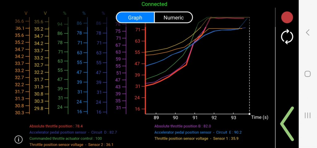

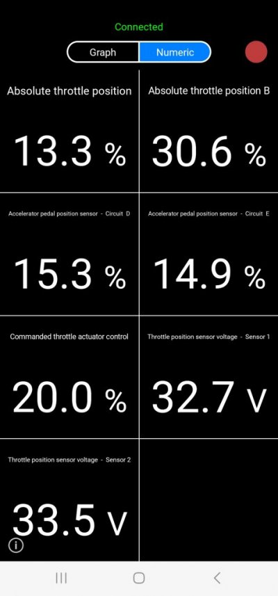

Thanks for the help! Here's a screenshot of everything with ignition off and slowly depressing the accelerator....the two abs throttles seemed pretty smooth. The tps voltage is way off though (see screenshot)... in the 30s.

Turned out that I had a damaged wire on the throttle body...it was shorting out and causing the problems. I must have slightly damaged it when I was cleaning the throttle body and it took a few months to get bad enough to short out. Take a good look at all the wires...mine are getting brittle!
