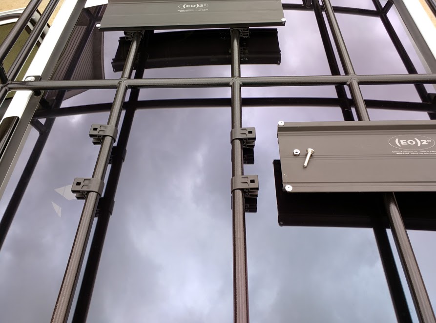

I used the plastic yakima round bar mounts, but I cut the bolts down (roof glass clearance is fine, but you need to cut them down). Used big flat washers on the under side of the plastic with a lock nut under that. The bottom rails needed to be mounted across the vehicle rather than front to back like you see other EO2 setups simply because of where the bars are on the voyager. You could probably get a longer bottom rail and mount front-to-back. This setup works well for huge cases because I can roll the case over the mount across the vehicle. This setup would suck without the flooring to roll the case on.

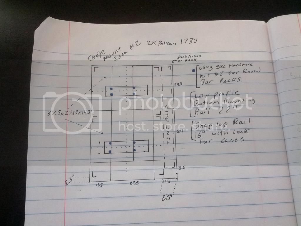

I started with a drawing...

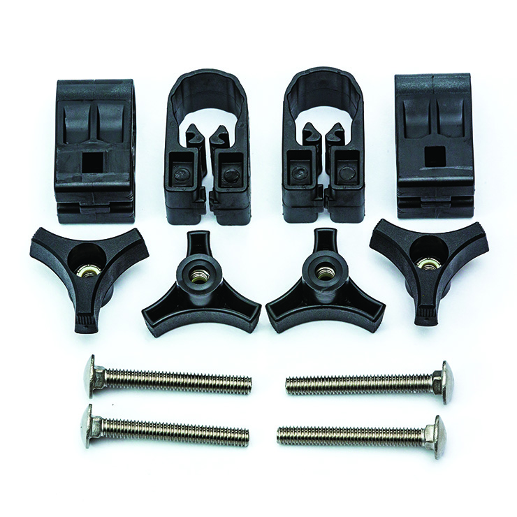

I bought the EO2 mounting hardware kit #2. I did not use the tri-handle nut things, but you can see they have lock nuts inside them. No way those would fit. I cut down the bolts (which is hard, they are stainless). From top of the rack going down, the order of components is bottom rail, bolt, Yakima Round bar plastic clamp, big flat washer to support the plastic underside of the clamp, then a lock nut.

Let me know if you have other questions. It was mostly just measuring and thinking about how I would use it. I wanted to be able to open both cases while on the rack, so being able to undo the latches, and have room for the lids,etc... so don't put them too close together on the rack.
You can't see the washers I used, but this is what those look like.

Wow, your glass is CLEAN!

I cleaned it before the pictures. The glass is a prisoner beneath the rack flooring, so it rarely ever gets a real cleaning. I try to shove a microfiber under the flooring to clean it up every so often, but for the most part I just let it be dirty and get rained on.
