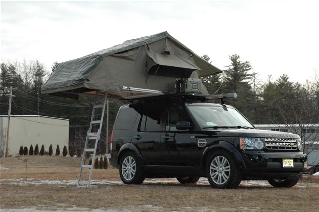

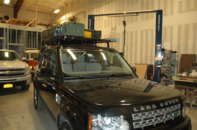

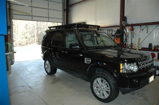

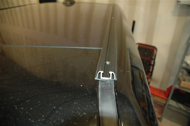

Not sure what tent you are reviewing but we recently installed the frontrunner track system, rack and Eezi Awn 1600 on a customer's LR4. The tent system has a ladder that acts as the 3rd leg and supports the unfolded weight. We have had no issues with installs, just don't over tighten the track systems. The 1600 is a large, queen sized tent that weighs around 250lbs.

Not sure what tent you are reviewing.. .
Any one. Those are pretty much the same. The ladder should be the third lag, but what if you are parked on the sand lets say? I think you would need some support under ladder...
