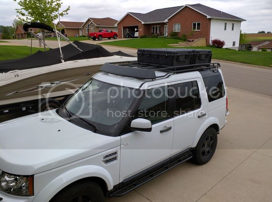

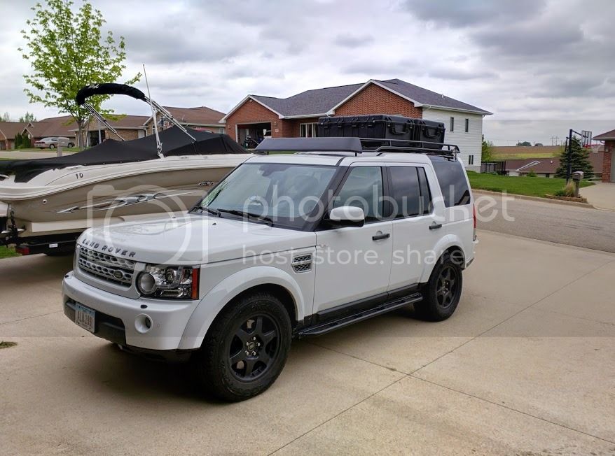

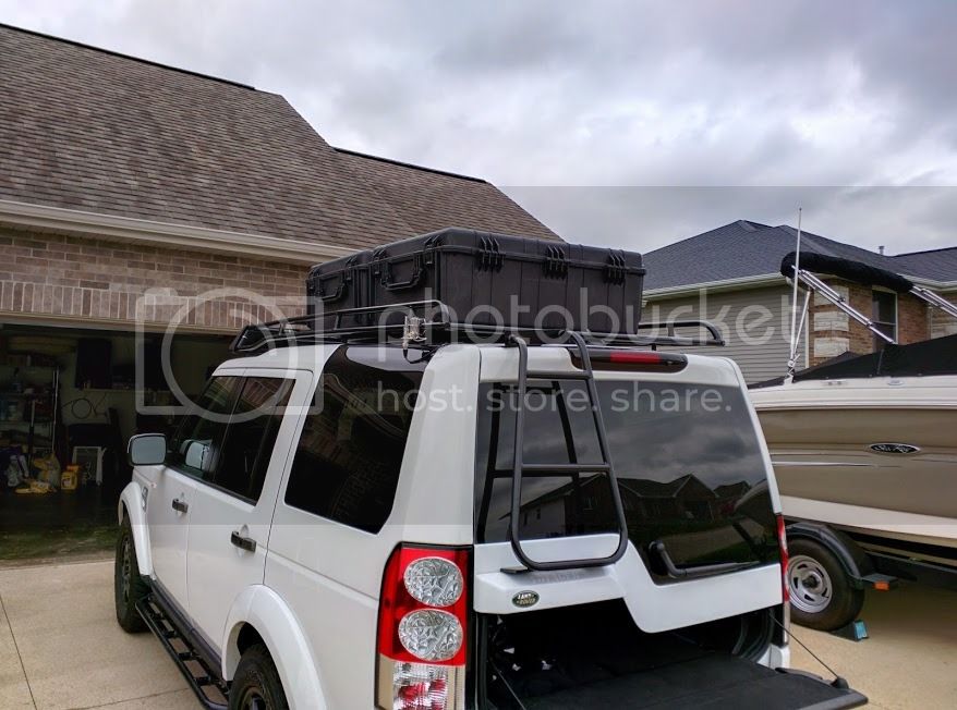

here's and idea:
factory rails with slots + thule or yakima cross bars mounted as needed to mount Pelican 1650 or Stormcase similar via drill-through for U-bolt attachment.
Tough, won't "break loose", waterproof, doubles as standing platform.

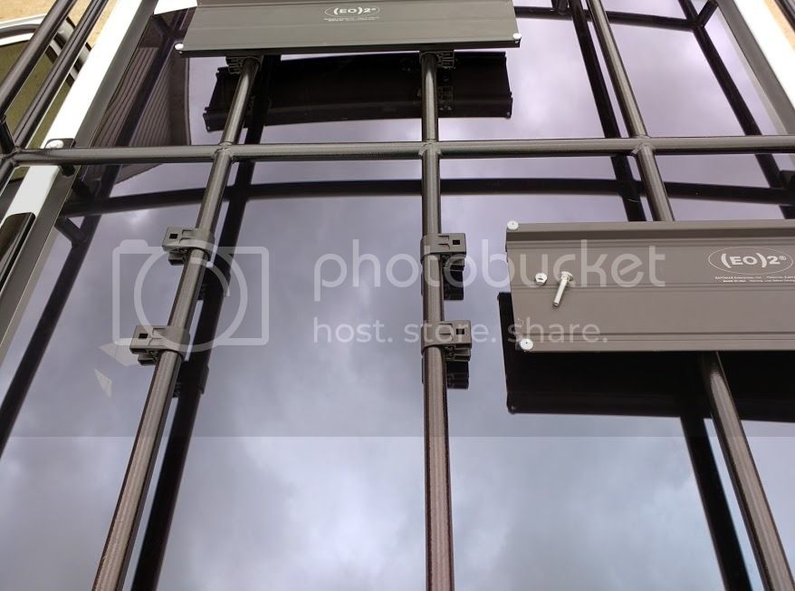

Here's something cool too, my 48" fiberglass waffle boards mount directly to the factory slots via DIY aluminum slot-tab, tapped for threaded rod, wing nut from above on hold-down plate. These double as standing platform if the rack isn't mounted (my Hannibal mounts such that these still tuck underneath).

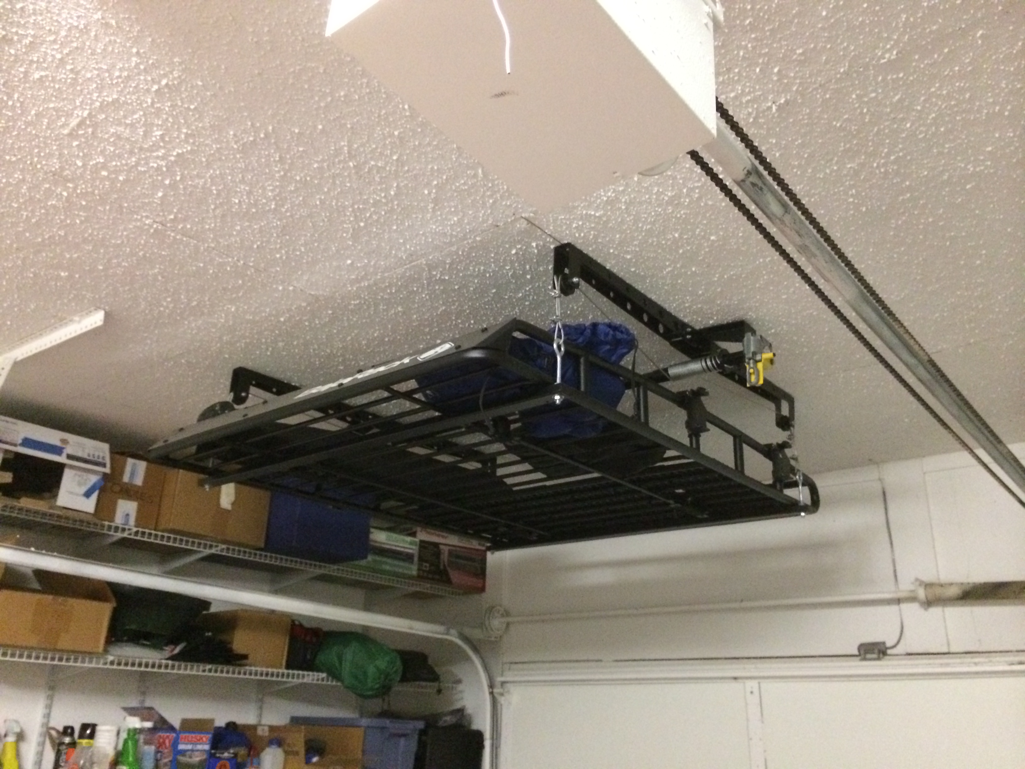

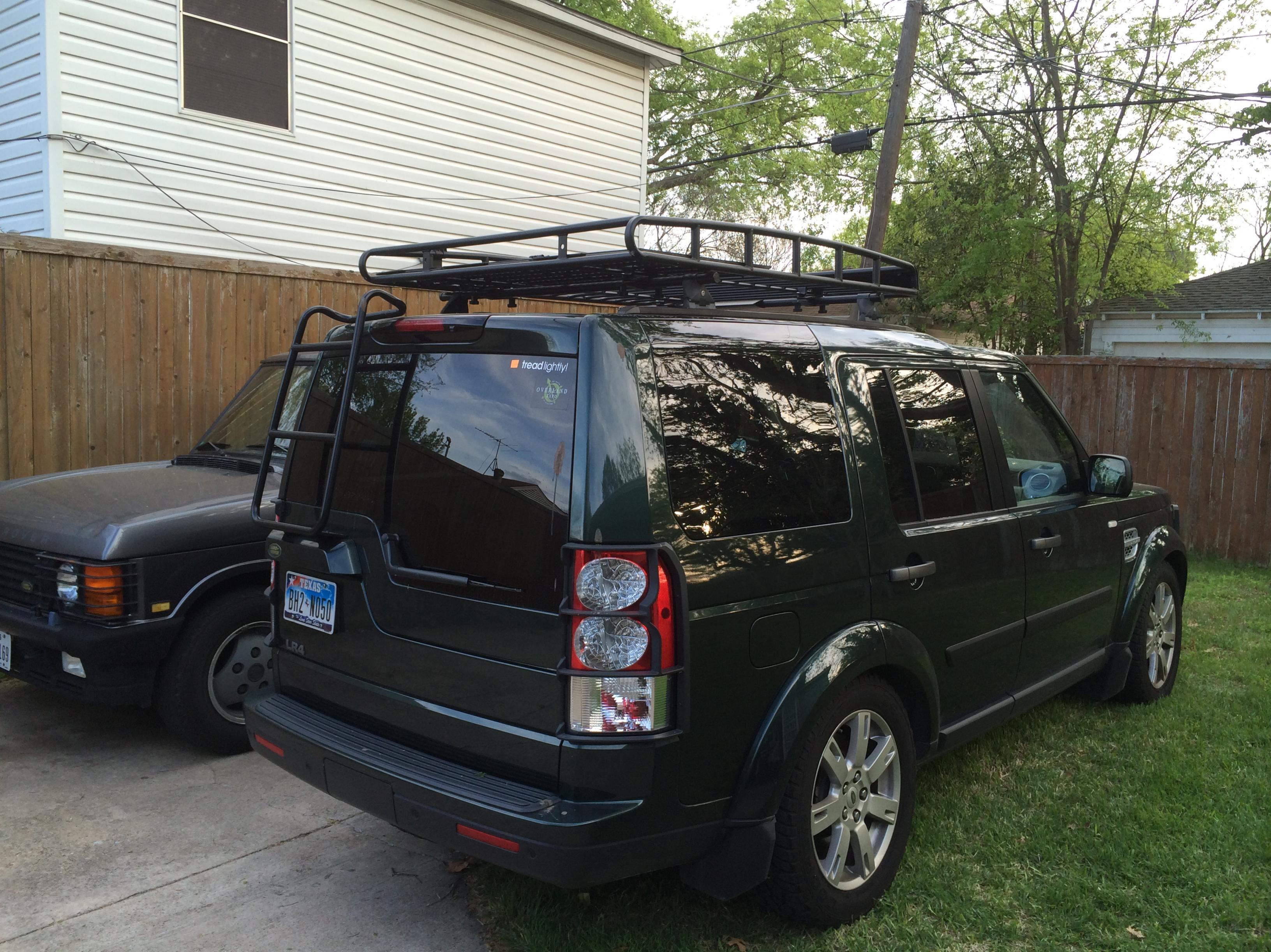

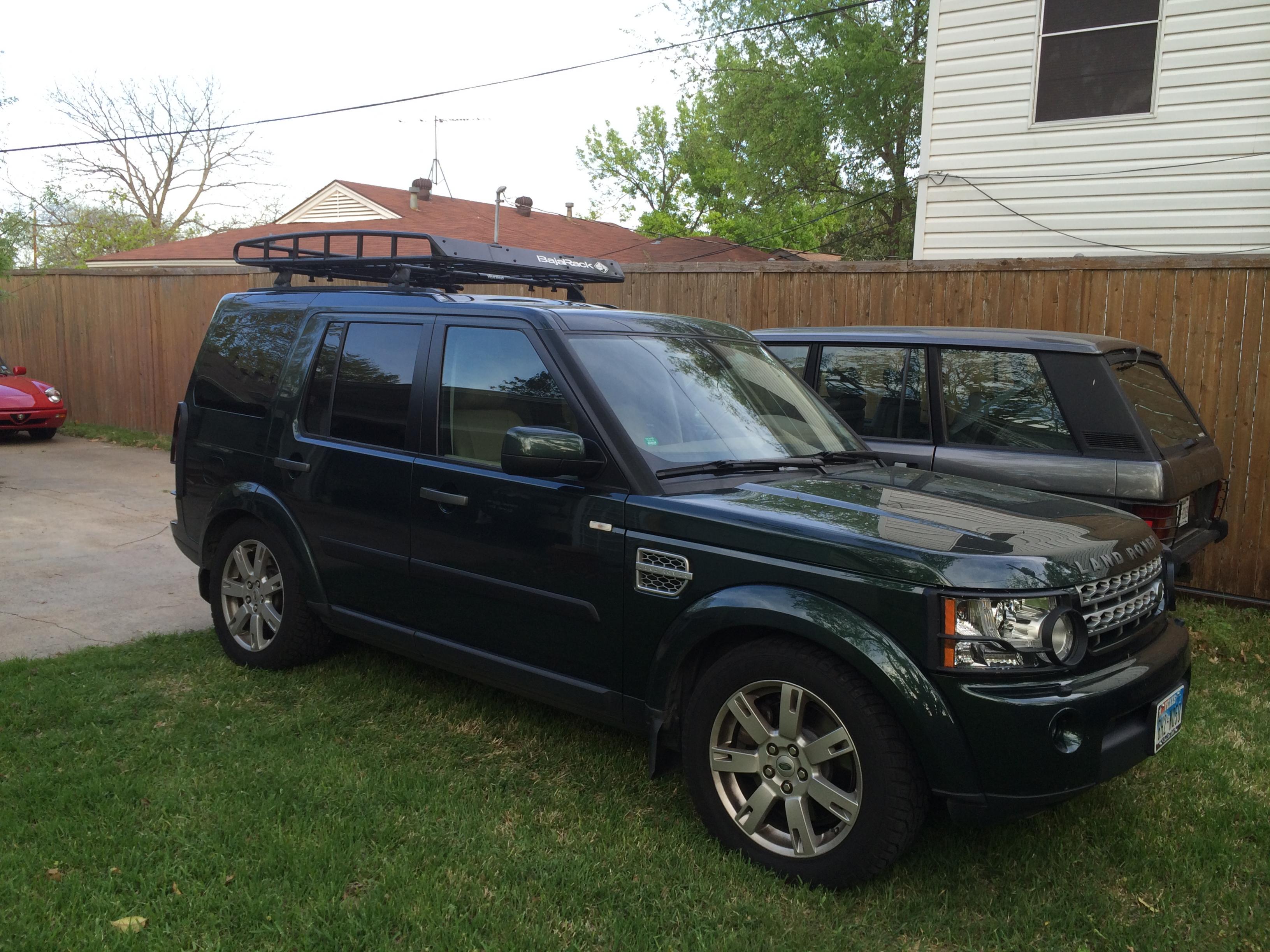

I basically only mount the Hannibal rack for purpose of using the attachable Hannibal awnings to make "rooms" primarily over the rear but also the full 90" side.
