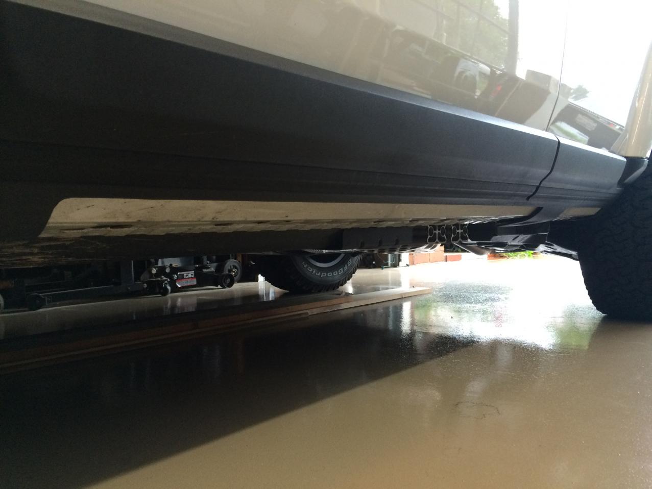

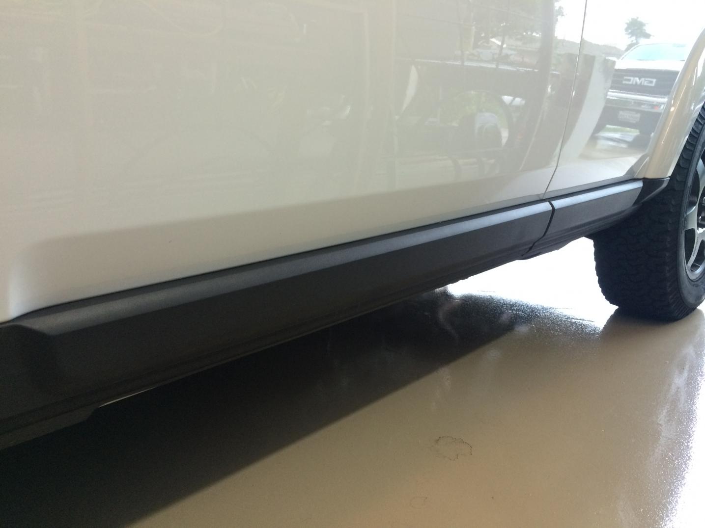

First shot is what it looks like at a 2' eye level.
Second shot is about 1' eye level. You can also pick up the aluminum extrusions under the rear passenger door.
You have to stand back about 10' before you pick up the notched trim, my white paint doesn't help.

Wow thanks so much for posting these! It appears the factory cut runs pretty much the length of the trim. Looks like the heat sinks may be more visible due to the lack of a complete trim pc? Or is this inconsequential in your opinion?
Waterndirt
Sep 28, 2013
309
64
I don't think the lack of trim makes a difference, if any its minimal.
