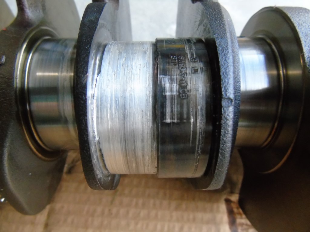

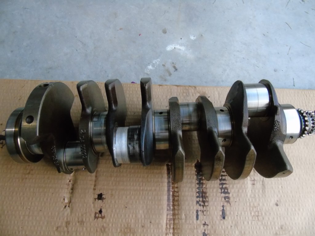

Here are pictures of the Crank removed. You can see where the journal is white in color. I believe this is part of the bearing that is still attached to the journal, as you cannot see the oil holes. I have contacted a machine shop that is going to re-condition the crank for me. I did not want to try removing these bearings as I did not want to damage the journal anymore than it already is. BTW, the journal cap bolts can be removed with a Audi/VW head bolt removal tool (T52). I just happen to have one of these from rebuilding the top end of a New Beetle 2.5L.

That's a rather nasty looking journal there plus what is under the other throw's journal as well the main to the left.
JMO i'd replace the crank and one rod after checking the other one next to it, had that replacement rod checked for length, balanced both ends with an overall balance matching the other seven rods.
Lack of oil, what do the bores look like along with cam lobes and the complete oiling system also requiring a complete cleaning as there must be metal particles from that failed journal.
Cast crank or steel, another thing to consider, I bet it's cast being cheaper vs any steel crank which can be welded up then ground to spec considering the time, labor and cost involved.
Rescuing a forged one off $troker crank is a different $tory being magnafluxed, having welded up journals then refinished to spec, rechecked for straightness then rebalanced.
That being a money no object rescue checked with the massively higher amperage magnaflux unit charging the crank end to end vs the "loop method" in the example below. We had at United Airlines engine rebuilding facility their magnaflux unit available.
Small general unit here as example; http://forums.pelicanparts.com/porsche-911-technical-forum/70746-magnafluxing-info.html
As mentioned above a no limit cost rescued one off custom crank vs in your case a common crank to be had and replaced.
A "cooked journal" restored vs a replacement crank without second guessing i'd replace it.
