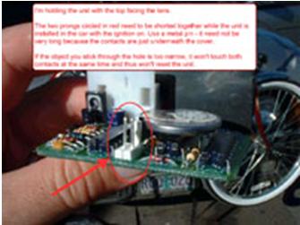

To reset the emissions warning light on the dash, you need to put a metal pin, approximatly 3/16" in diameter through the hole in the top of the package (ignition must be on). The pin needs to contact the 2 prongs show here, making the connection between them:

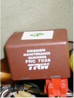

Remove the passenger side kick panel and locate the Emission Maintenance Reminder which is the red box. (See fig.1 & 2)

Remove the box by lifting upward. With the box removed, either peel back the Land Rover sticker or poke a hole through the sticker with a long rod to reset the reminder.
