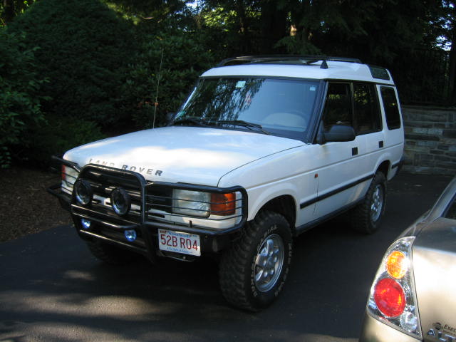

Its a 1995 white Discovery
-Here she is:
