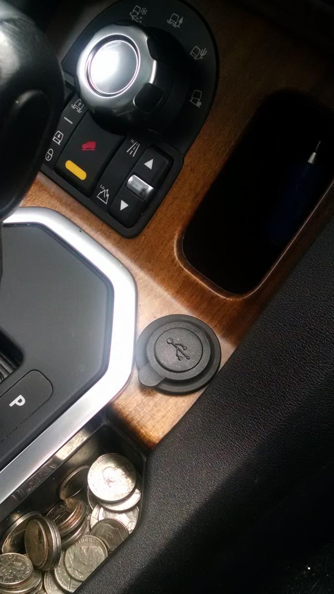

It's the Blue Sea dual USB. Required some trimming of the console opening but only 1-2 mm. I still haven't gotten it to work but I haven't had a chance to look at all the fuses and do any diagnostics. I can't see why it won't work. I use these in my 110 (which is where I stole it from for this project as it was a last minute hey while I'm here let me do this thing I've always wanted to). ImageUploadedByTapatalk1433174926.468839.jpg

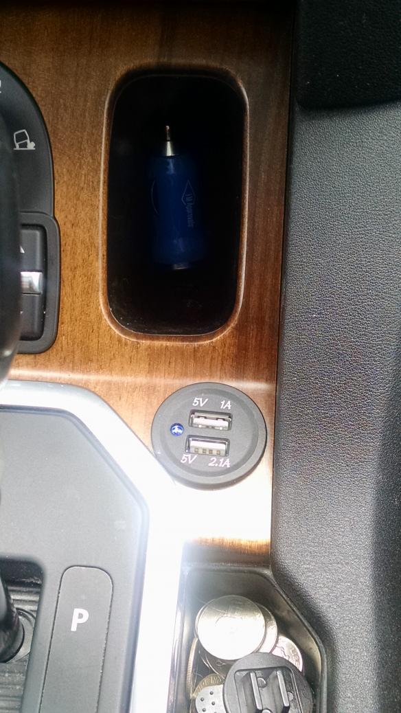

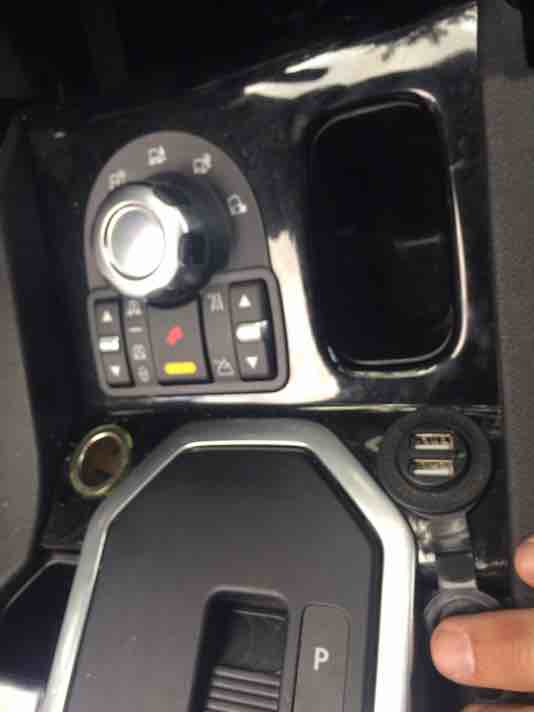

Liked the idea so much I added one myself.
Dual USB charger.
I also installed one in the cargo area in conjunction with a traditional power port, that I can switch constant power on so if i need the power on to charge something but don;t want to start the vehicle :)

Did you have any problems w the wiring and power? I haven't had a chance to diagnose my no power to the port but wanted to see if you did anything special? I literally cut the wires off the OEM port and crimped on some connectors as I have done dozens of times.

I just cut, crimped, and plugged the wire in, make sure your + and - are lined up properly. Also check the fuse to make the wire didn't touch during tear-down/install. Sometime just that one strand of wire can do you in :(
Other than that maybe a faulty plug?

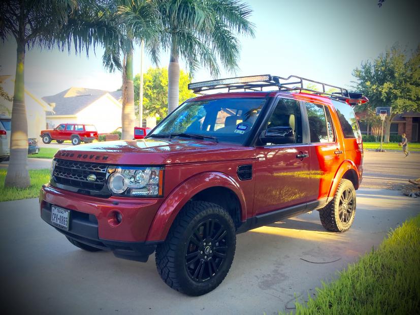

I am still digging the look After a week of having my rover back. The duratracs ride great and have no noticeable road noise I wish I could say the same for the light bar.
NASdiesel
Dec 21, 2011
648
60
It is the rack likely. You need a floor to smooth out the air flow.
