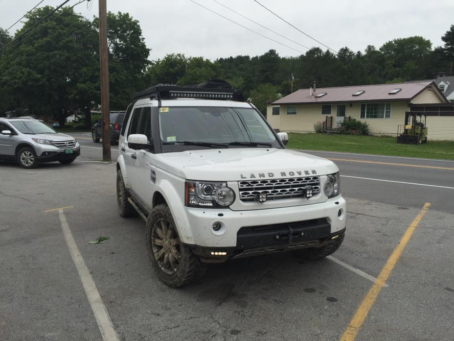

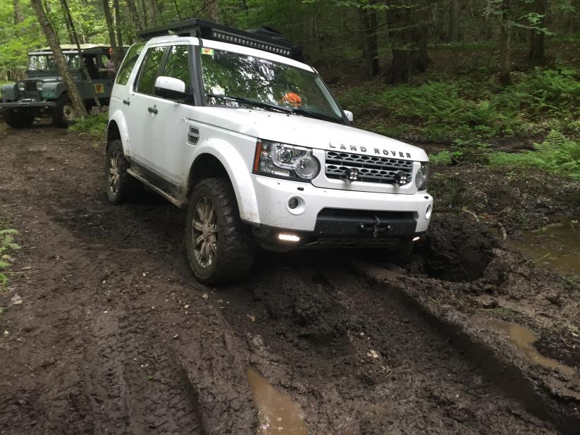

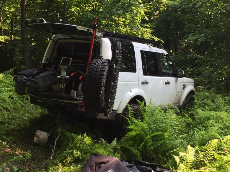

Have been doing quite a bit of wheeling lately in VT pre-running trails for Vermont Overland for the upcoming VO Trophy as well as day trips. Will be posting up pics. But pleasantly surprised and happy with how well the LR4 runs offroad.

NASdiesel- illuminate us with the choice of lights on your grill and how did you mount them? Are you happy with them? Close up photo? I assume they are more of a flood/fog light? Did you run a separate switch and to where? I am thinking of doing the same. Are yours bright white or the less than bright white type? I see the LED bar on the roof rack- are you running 2 batteries - or with LED - not needed?
Good looking rig!

NAS, how's the wind noise with the front runner LED bar on the roof?

NAS.... full list of mods please! :hello:
Also curious what model and if you have the HD package?

I'm using a Baja Designs set of lights (Driving) on the front grille and superbrightleds.com light bar under the rack. I think there is an older writeup on the mounts I made and incorporated. I'm actually unhappy with the baja lights. They throw an okay amount of light but not what I expected. The led light bar on the other hand is terrific. The reflectors are high quality. All are a brighter white. I run the lights off the garage door switches using a wireless relay setup. I do have a second battery but the lights are wired to the main battery. They don't draw enough and I only have them on when the truck is on anyway.

Excellent now that I did away with the gap between the light and rack. When I first installed the light, it left a 3/4" gap that caused the most ungodly whistling that was deafening. I cut down a piece of L aluminum stock to mount in between and that has made it extremely quiet.

I have a '12 HSE with HD package, cameras, and pretty much everything except the lux (which I wish I had gone for). Hidden warn zeon 10K winch in winch tray in the front, Devon 4x4 skid plates, tactical rover rock sliders and gas tank skid, front runner rack, Kaymar rear bumper with tire mount, Kenwood 2M radio with APRS, britpart rod lift, a bunch of other interior mods (luggage partition, 12v ports, etc). Tires are 275/55R20 with a 3/4" spacer.

That is exactly what I was looking at for the grill - Baja Designs. I am looking for more of a flood/fog so for me they may be fine. Your input is a big help. I will search the thread for the mounting system your used for the grill. I mostly need the lights for snow and dust at modest or slow speeds and may even get an amber lens.
