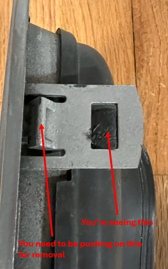

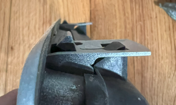

I removed the driver side vent this past weekend (looking at sunroof drainage issues); for those of you trying to go in via the engine compartment and down through the hinge opening pay attention to this photo:
It's certainly interesting to get it out, I ended up using a trim removal tool very carefully; they don't come out very easily!
