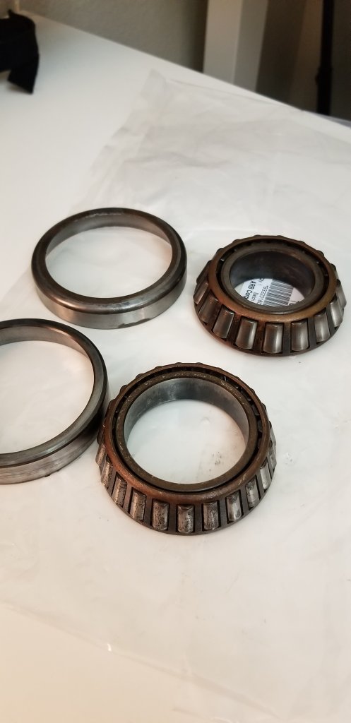

mflecklr3, that was my LR3, I just got it back today. Paul at Oceanside also mentioned to me that they had another LR3 coming in! It's really cool to know it's another forum member. I'm so happy I finally got this done. The bearing noise is gone. I had them do the full bearing kit with an ARB locking differential.
Here's a photo of a couple of the rusty bearings that came out of my differential. They all looked like this. The cages were all covered in surface rust. It seems like the previous owners not only never serviced the diffs, but I think they had let the truck sit for a while before selling it, and the condensation/evaporation cycles caused the built up moisture to form rust.
