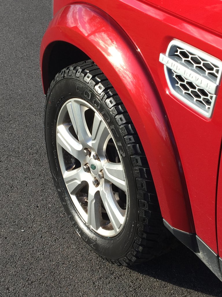

After a ton of research and looking into these forums, I purchased 255 55 R19 Cooper Zeon LTZs for my stock 19" wheels on my 2013 LR4. Love them... they stick to the road and there is very little road noise.
Just took them on the highway and now don't love them so much. My steering wheel now vibrates at speed of +60mph. Is this a balancing issue? The store said they balanced and tested for need of alignment (did not need alignment). Anyone else have this issue?
