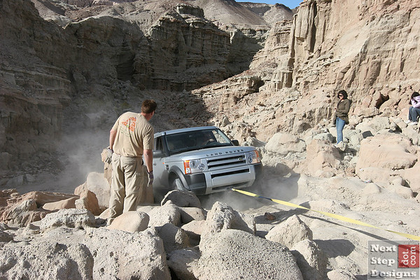

Great article, and great advice by all. If I can offer any advice, and I am just as guilty as any, keep people away when pulling, line covered or not. (Nathan, I'm not trying to beat down your photo), There is no sound like that of a strap giving up during a pull, and I'm sure no feeling like it either, if you get my meaning. At the same time one or more of the vehicles may be throwing rocks, and when the stuck one gets the traction, he can get a little out of control. Everybody always want to congregate during a pull, but do what you can to maintain a safety zone.

As for this particular hill, no way to do it with the hood up, it's far to difficult a hill and requires significant driver imput because of all the trashcan sized boulders and the trail zigs and zags it's way through them. it's a tough pull. Fortunately, on our second trip, I was able to get all the LR3's and RRS's up it on their own power.
