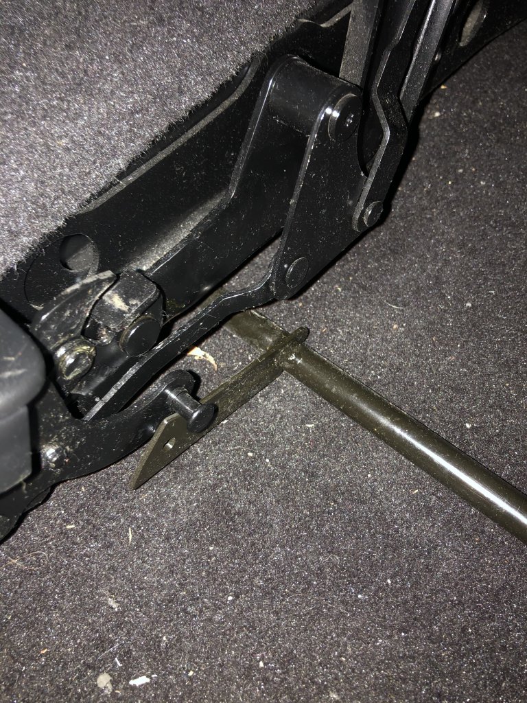

I had the same issue with my 3rd row, it was one of the rods that was bent. I'll try and send a pic later, it was an easy fix once I figured it out

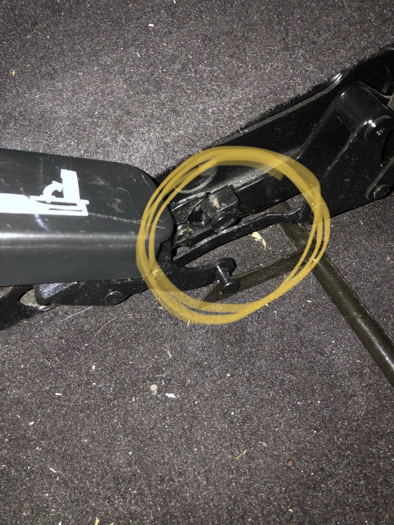

When I had the issue, the rod in the picture got caught on the "bolt head". I used a screwdriver to put it back in place. The key is to play with the back of the seat to open it and then you can adjust the rod.

Sorry for the late response, you will need to use some force to open the seat. use one hand to lift the latch and the other to pull the back/open the seat, try to wiggle the back of the seat to open it. Once you open it, see if any of the rods are touching each other.
