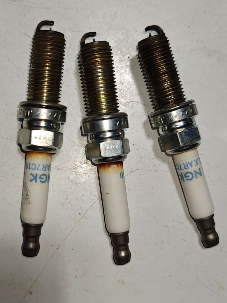

Pulled my plugs to chase down a misfire. I’m not sure what the coloration means, can someone help me figure this out?
Cyl 6 has a small amount of liquid that smells like fuel. I’m guessing I’ve got a leaky injector…

I wouldn't suspect those spark plugs as the root of your issues.
Clean paper air filters, clean maf and clean throttle body is where I would look first.

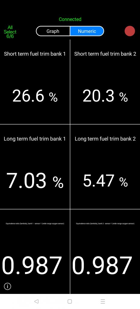

Thanks. I did all of those things. After replacing the spark plugs and looking at my fuel trims bank 2 still seems to be off. Though the rough acceleration has tapered off. I'm starting to think it's an O2 sensor.

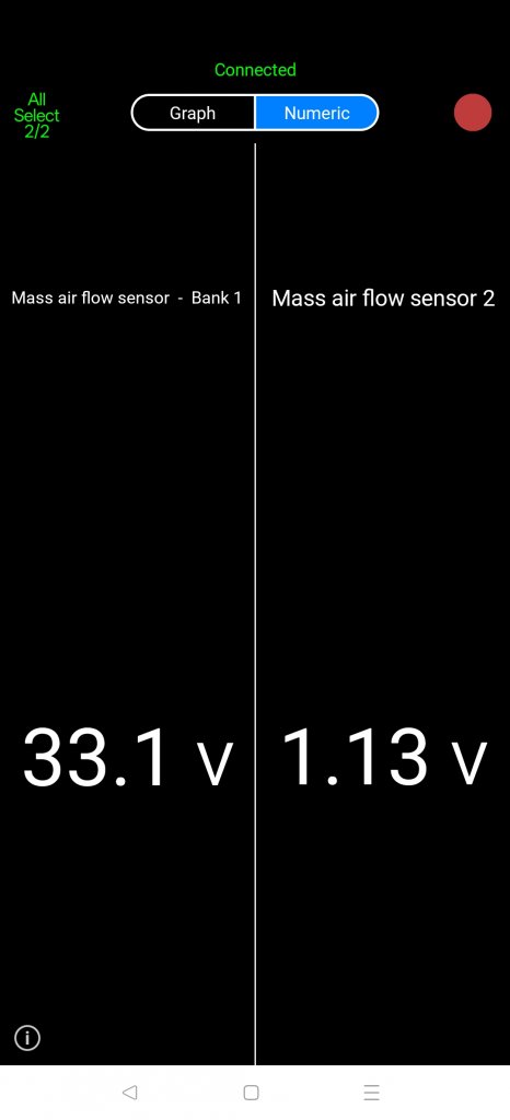

Based on the MAF sensor voltage readings I'm starting to think bank 2 MAF is bad...thoughts?

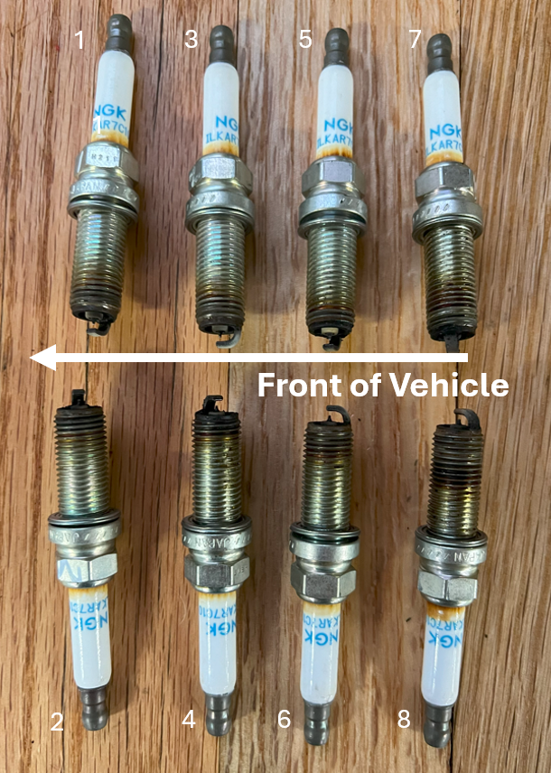

FWIW - Here are my plugs, removed a few days ago, cylinder numbers are marked, so bank 1 (passenger side) is 1, 3, 5 and 7; bank 2 (driver side) is 2, 4, 6 and 8:
This is all part of the timing chain job, I'm changing the plugs while I'm in there!

Thanks for sharing. After changing the plugs, doing a compression test and cleaning the injectors thoroughly my fuel trims have improved but I am still running lean in Bank 1 with some hesitation. Sometimes reaching a combined long-term and short-term fuel trim of nearly 20% when driving. I've read another thread that spoke about in tank fuel filter potentially being an issue but given it's only happening in one bank I'm starting to rule that out. I'm wondering if it is the O2 or MAF sensors though voltage on both reads just fine. Any more thoughts are appreciated!

I wouldn't expect the MAF to cause that since there's a single throttle body, if it were bad it would affect both banks equally. An O2 sensor could be it, though - if the reading is close to normal after the fuel trim take effect maybe it's just off. Can you swap side to side and see if it follows the sensor?
