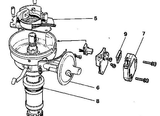

The manual I have only goes down to the level of changing the entire distributor. Here is the blowup if it helps...
