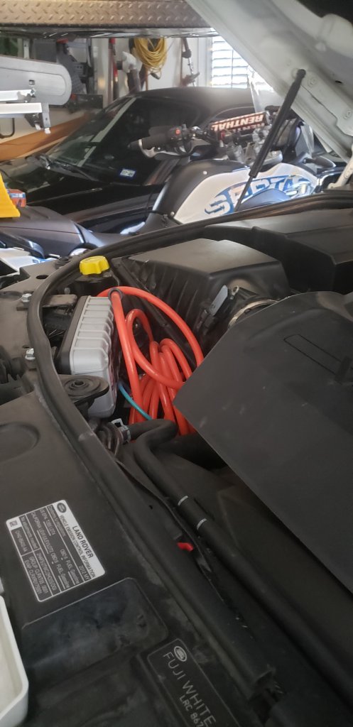

The Lone Star State
Seems like it would be easier just to buy a small compressor.
It's in there under the orange hose somewhere...;)
