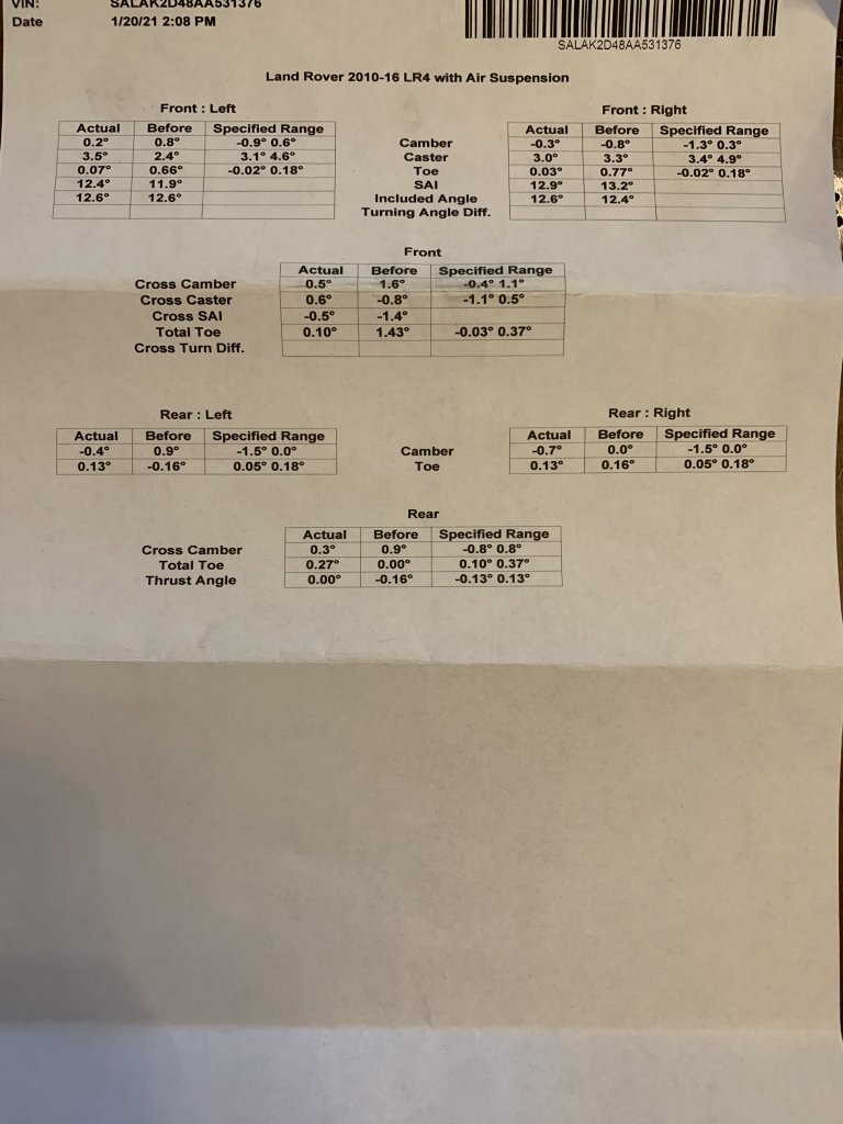

    I use firestone's lifetime alignment and have had to make them redo it a couple of times. Can you post a picture of the printout?
    If the alignment is indeed correct, I'm not 100% sure. It could be clutches in the front diff are worn causing torque vectoring to one side. I would think, if that is the case, the left wheel is getting more torque and pushing your truck to the right. I feel that this is unlikely though.
    If it is alignment, then I would suspect the right wheel is pulling to the right and would have incorrect camber or toe in on that side.

    Here’s a picture of the alignment paper.
