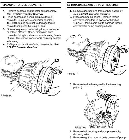

hey i am trying to get my engine pulled out and made it to the torque converter bolts and wondering if anyone knows what size they are and how is the best way to remove them thanks

What year Disco? Not that this makes that big a deal... should be just trial and error for a few moments.
