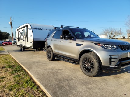

I am using the anderson. More for sway than weight distribution. The D5 is a fantastic tow vehicle dare i say it but even better than my LR4 with the 5.0 in it. Rock solid at speeds even when being passed by a semi.
