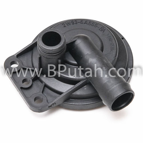

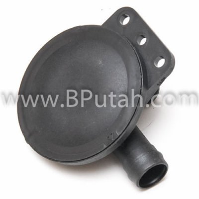

LR part number LR003380
Thanks, I found it now; pictures below and yes, this is for the petrol 4.4 litre V8 engine and what was installed. The MIL engine check light has not gone on for the last couple of days so maybe the Positive Crankcase Ventilation valve was the problem.

bbyer, what was the cost for that sucker?
cmb6s
Sep 3, 2013
152
IIRC, PCV valve is about $50-60 and takes literally 2 mins to replace. Compare that to my L322 which takes hours to do and it's obvious that Ford people may have had a little more common sense than the BMW folks. :p

yes, almost fun to replace
My cost here in Canada was about seventy five Canadian however in the States per above, it runs about fifty to sixty US dollars.
And yes, taking the black plastic engine cover off is harder than replacing the PCV valve - for once.
