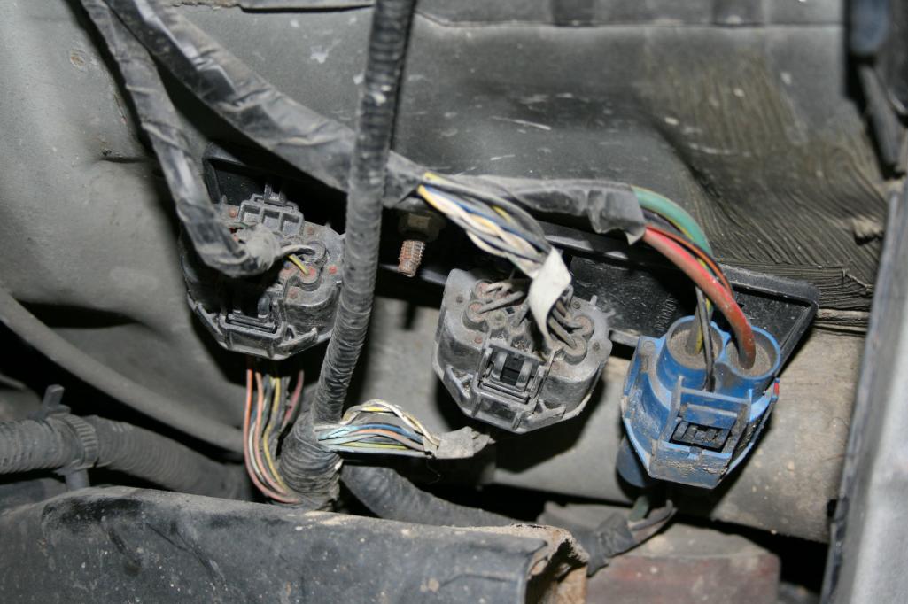

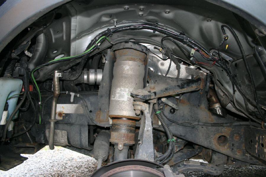

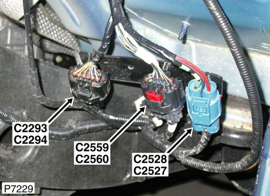

Your mention of the yellow park brake light brings to memory a recent problem and solution.
I started with the park brake light going on, then the antilock/antiskid lights came on to say I did not have those systems and then the air suspension wanted to drop in response to the "unsafe" situation.
Ultimately, the problem turned out to be a broken conductor related to the left rear wheel speed sensor.
The wire break was found to be in the left front wheel well behind the wheel well liner. This is a location that is prone to wire breakage so some reason.
The jpg attached shows the three connectors that wires feed into. Generally the breakage is on the wires off of one of the three lower connectors in the first three inches. The middle picture shows the wires off the middle connector in bad shape - something like that is what you would be looking for.
