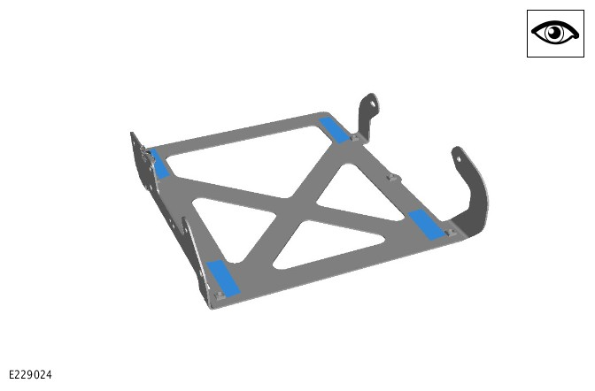

That isn't an LR4 TSB.
I thought you were referencing the conversation with "Rover Range" where he mentions removal on L405. On the LR4, Bracket and heatshield are not removed/discarded, bracket is replaced if cracked and heat shield is reinstalled. On my L405 per TSB, bracket and heatshield can be removed/discarded. Sorry for confusion, two different trucks being discussed.
For my LR4, which did have the rattle due to crack in bracket, I found a stronger bracket on ebay, and much cheaper, and replaced per "Rover Range".
Rover Range
Jun 13, 2022
1,081
758
Texas
TSB for the LR4 is, LTB01207
Renew bracket and install foam pads as shown.
