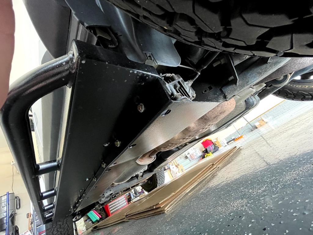

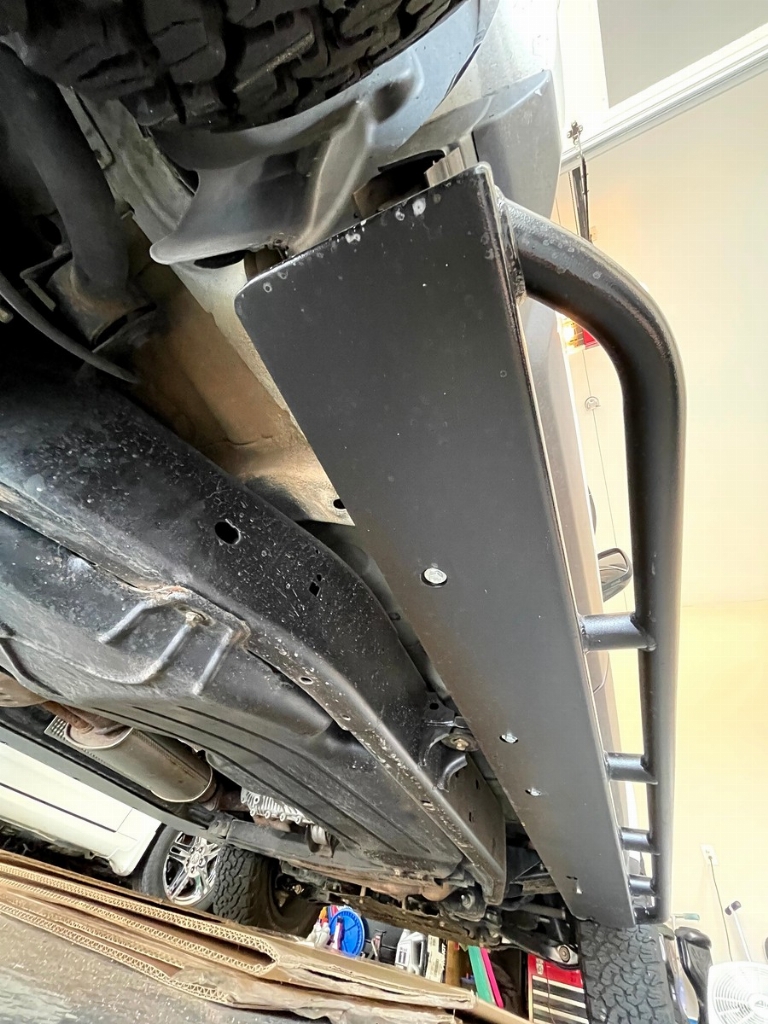

Slight tangent, but here are the newly designed Voyager sliders with bolt on air compressor/tank guard. Much lighter than the T44 but plenty strong and the step is much larger and ORDERS OF MAGNITUDE more comfortable to step on and use. (the main reasons I changed was step comfort and weight). They were kind enough to make these for me custom but I imagine they would do it again on request. The fitment is perfect and they seem plenty strong but are not insanely overbuilt and heavy.

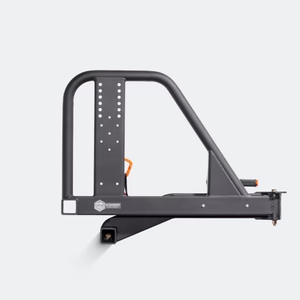

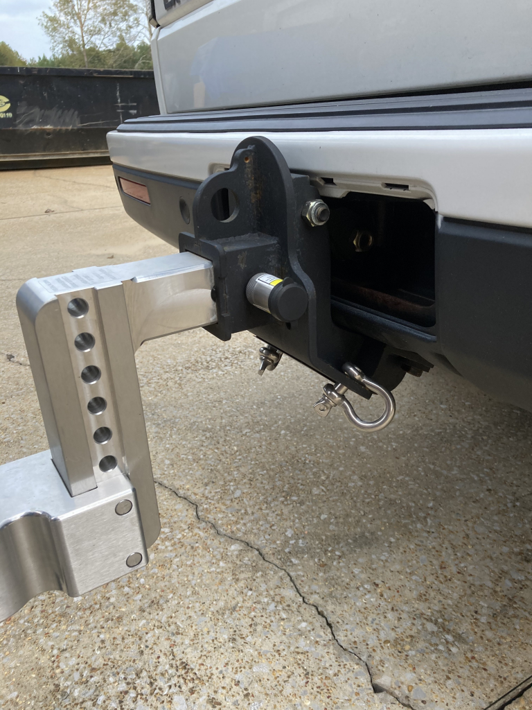

I have the rhino ox hitch and this makes the tire carrier sit too high. The short oem hitch would do a lot better, BUT you lose a lot of departure angle.

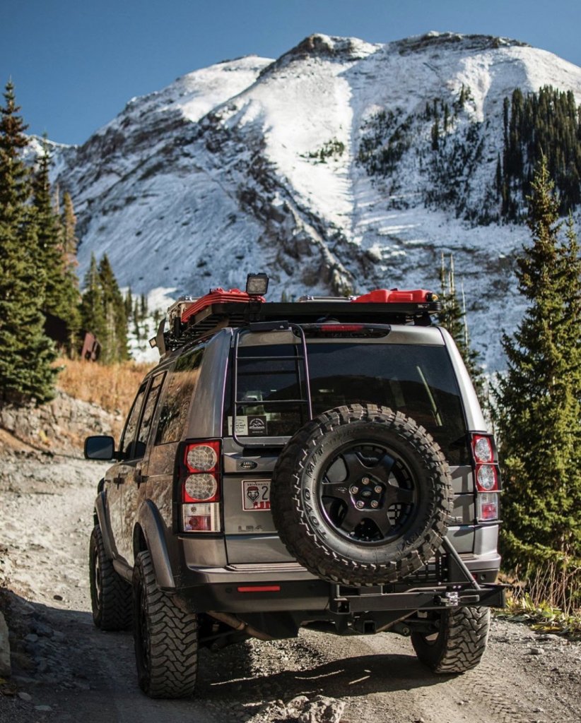

Hey, can you clarify this? Wouldn't moving the carrier to a higher point, via the ox hitch, be better than having it on the OEM unit which hangs down however far? There's a Rigd multi-swing for sale near me so considering it and trying to figure out how low it would be on the OEM quick-receiver. This picture looks pretty good, with my matching wheel and everything.
djkaosone
'11 LR4 HSE LUX 5.0L V8
Oct 26, 2015
1,092
777
SoCal
When I say it sits too high on the Rhino OX hitch, the hitch tire carrier will fit, BUT when the tire carrier swings open to access the trunk the tailgate hits the swing arm of tire carrier.
Oem short hitch reciever sits 6" lower and the the Rigd and dirtcom tire carriers work, because of the built-in raised angle clearance of the hitch. If you find a straight arm like wilco, that might work with the Rhino OX hitch. Still have my doubts, because the handle might hit the tailgate.

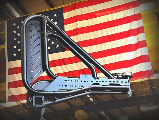

I had the Yakima Swingback and the arm hits the tailgate. Tire carriers with the raised arm like these images will hit the tailgate.
If you want, I can take some measurements between the hitch and tailgate when I get home. Just looking at the picture, I'm guessing there's about 4" between the top of the hitch to the bottom of the open lower tailgate.
