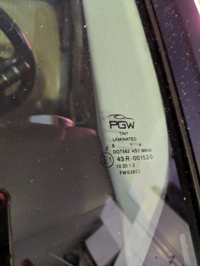

PGW is what I got a few months ago. Seems to be working well. Maybe a little slower to defrost than the original one it replaced, but still works great.

Sounds reasonable. Drawing less current, taking more time to melt stuff but at least your fuse box isn't melting!
So far I have had a replacement Pilkington, Benson and Fuyao all blow the 40 on both or passenger side. Next time I guess I will try PGW!
