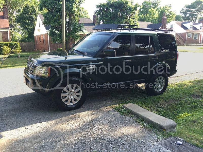

1. Yes the sunroof opens all the way without interference.
2. Not sure what kind of cargo boxes you mean, but I can get a pic of the floor tubing so you can see what the layout looks like.
I ended up cutting off both side rails in order to fit my roof top tent. You can see what that looks like in the pic.

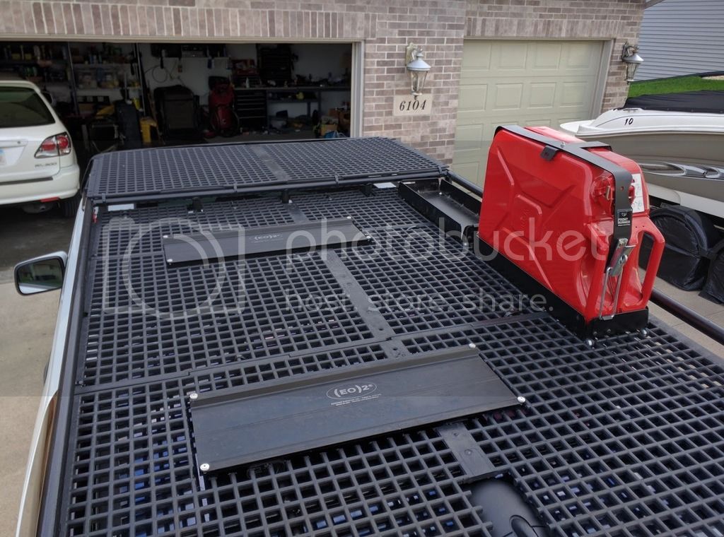

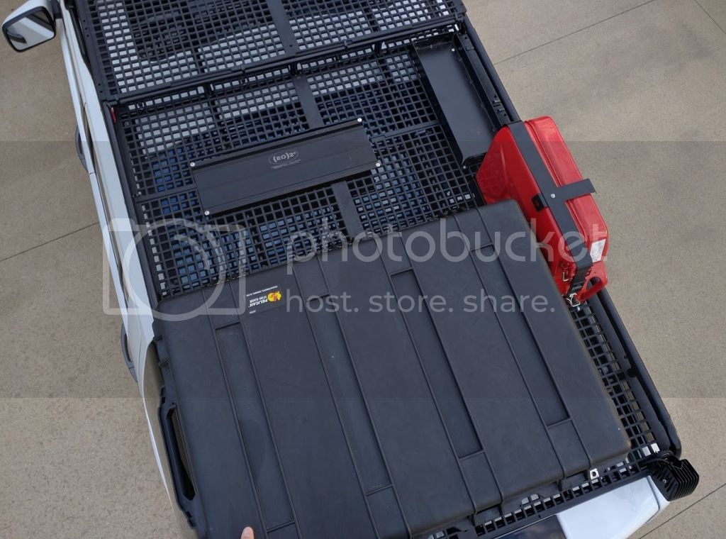

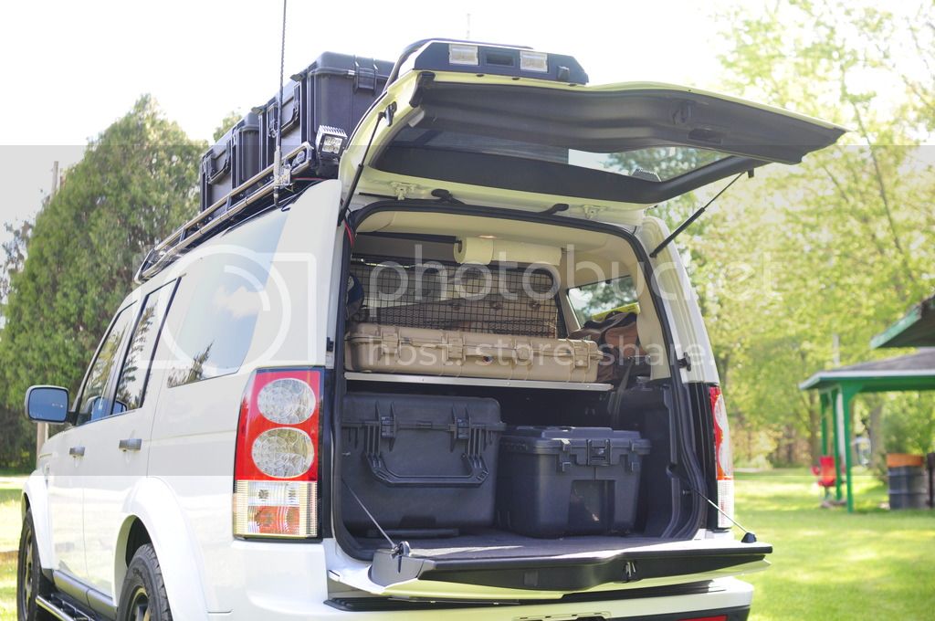

EO2 mounts... I can put two 1730 Pelicans on my rack with EO2. They snap on, lock with a key, padlock the cases. Secure, waterproof, easy to open while still on the rack (I just throw camping gear in them and unload them while on the rack)

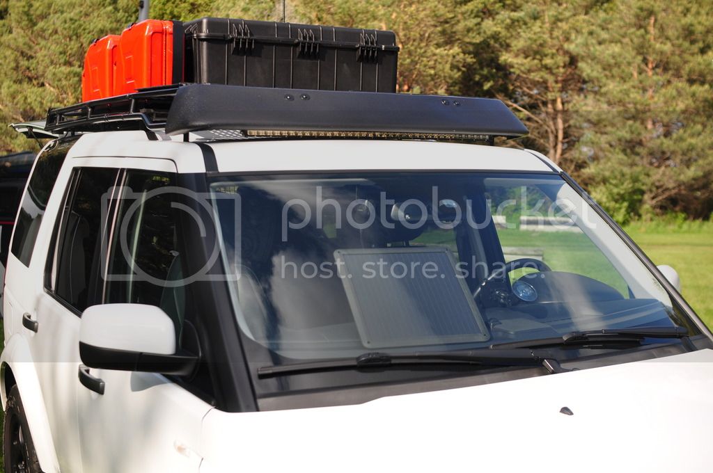

Also in case you are interested, the voyager fiberglass win fairing works well, once you figure out a good way to attach it.

What flooring do you have on your voyager set-up? In the photos, is doesn't look like either of the options voyager offers, and I am a huge fan of your current config. Exact details of your roof set-up would be greatly appreciated. Thanks

The flooring is PolyMax Overlapping Poultry/Kennel Flooring
https://www.farmtek.com/farm/suppli...terials-ft_mats_flooring;pgha2215_HA2215.html
It is easy to cut, waterproof, and will stand up to walking on. I secure mine with just heavy duty zip ties and change them once a year due to UV rays making them brittle over time. You could use rubber insulated hose clamps or something else, but the zip ties has been very strong.
