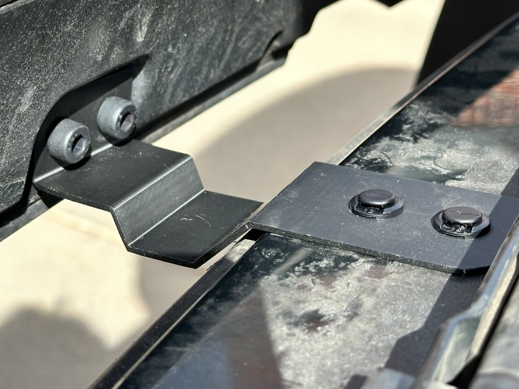

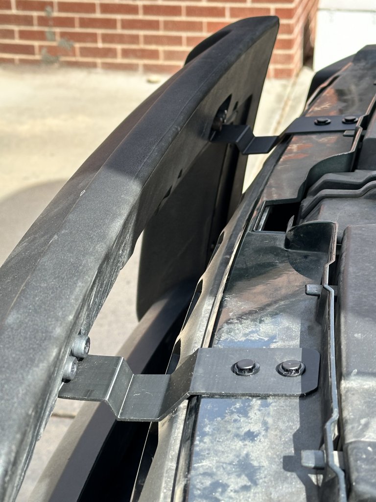

If anyone has inherited an OEM brush guard with missing top brackets on their LR4 then here’s some info. Driving around at high speed with it flopping around finally got to me.
I had a hard time finding the brackets, or replacements. I’m not in the market for a new bumper and didn’t want 4 holes in my bumper (or repair work).
So I ended up 3d printing them. Remixed a design I had found that didn’t work. Files attached along with imagery. I would thicken it up slightly if redid, but this works fine (for now).
Drivers side: https://www.tinkercad.com/things/ld...e=Xy-68UjwE7NTJKShjc4hDNaD6foVDt4P7A-LmFSb8Oo
Passengers side: https://www.tinkercad.com/things/jt...e=RojmjLohYjOIN7SYEMndbwiPdToy6JJQTDR8fY5O60o
Additional hardware:
4- m8 1.25x20mm cap screw
4- GM body retainer fastener (9971227)
Maybe this will help someone, and if not, at least I have it documented for when I need to reprint the brackets
