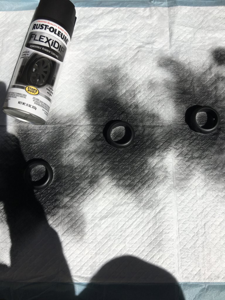

Hi, if you want to save money take a butter knife and put it behind the knob edges and pop it out around the edges, you’ll have to do this around each knob.
I soaked them in soapy water, then used a green scotch-brite style pad to get the gummy stuff off. I then sprayed about 3 coats of Rubberized spray, you can use Plastidip but I found that the Rustoleum spray came out in a finer mist and dries very smooth. I did this because after I removed the gunk and re-installed the knobs they had no grip on them and it was annoying to turn on the AC. Now they have grip and actually look stock.
Here’s a photo I took today after spraying them.
