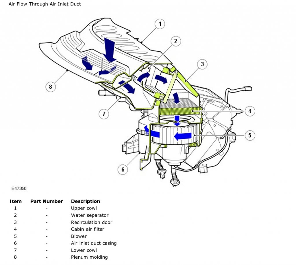

When you replace the cowl, take a look to see if you can locate a structure that is supposed to deflect water away from the HVAC air intake. I remember someone posting once about a splash shield or something like that which is supposed to deflect rain that escapes through the cowl away from the HVAC intake, but it was either bent or just not quite long enough or something like that, so that it would catch the rain dripping off the leaking cowl. They fixed it by bending it or attaching something too it - can’t remember, and I’ve never looked at it myself. But the air intake seems to be right above the cabin air filter. The attached illustration sort of shows what I’m talking about.

I’ll look while I have it apart to see. It looks like #2 on the illustration is what may be the issue or there abouts.

After replacing the cowl this weekend I’m confident that the issue was a result of the cowl “warping” where it meets the windshield. The water separator in the illustration is like a trough that diverts water away from the fan inlet; mine was still connected like it should, but I could see tracks in the surface dirt from where water had gotten behind/under the cowl and ran down. The fan inlet has a metal bowl shaped structure that accepts the actuator door right below/behind the water separator. the most likely scenario is water gets under the cowl and runs down or splashes off the separator into the fan inlet. My apologies for not taking any pictures, i started tinkering around and ended up replacing it without thinking about documenting.
