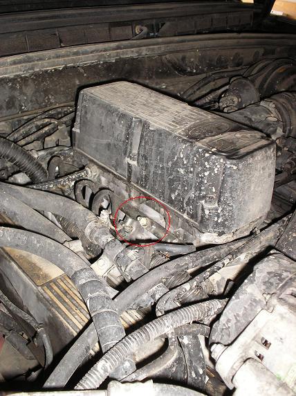

Ok my mistake i was looking at something else what does this do?

That is the shrader valve for fuel pressure..., but the hose in the back ground is the one everyone else is asking about....

Thanks Joey so this i nothing i have to worry about ?
I had better go wash the engine before i take anymore photos
Thanks

Nope, nothing to worry about, can't tell by the pic, but if it doesn't have a cover (valve cover from tire will work) I would put one on, keeps the dirt out.
Wash the engine.... it might like that, and ask for it more often.... :)
