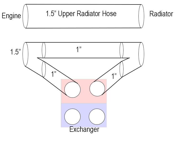

A dedicated circulation pump to run coolant thru the heat exchanger would be needed to hydraulically discouple the car’s system from your water heater. The benefit is that is wouldn’t affect the vehicles system at all. If you position the heat exchanger in the cars system such that the cars water pump pushes thru it then the pressure restriction of the heat exchanger may have an adverse effect.
greiswig
Mar 1, 2021
671
300
SW Washington
I agree. I don't know much about the system, but I know there's a 1.5" inlet on the radiator. No idea how the flow capacity of that compares to what the maximum flow that a full-open thermostat allows, though. And I don't know to what extent putting an additional restriction (although I don't think the heat exchanger is actually very restrictive, it still has 1" inlet and outlet). But I'd think that basically putting a Y in that was 1" on both paths might allow enough flow through the system and not interfere? Like in this diagram. Unmolested radiator hose on top, then the alternative Y'd path below.

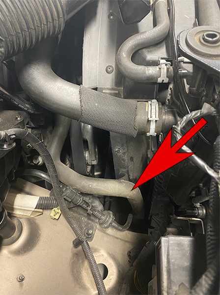

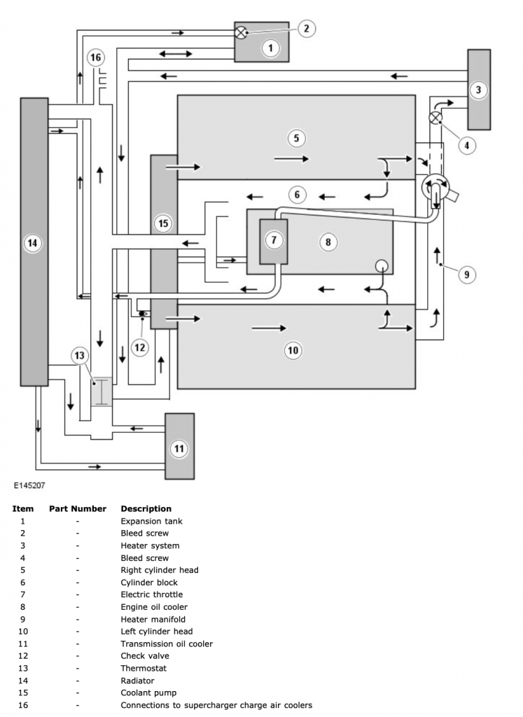

Getting back to this again. I'm wondering what this hose is that the arrow points to here. The manual seems to say it goes off to the supercharger air cooler, and the two hoses that the diagram shows as running off to the right DO that, but the end (where the 16 is) is around a 5/8" hose that just seems to run down, and I can't tell where. Wondering about putting this heat exchanger in series with that.
greiswig
Mar 1, 2021
671
300
SW Washington
OK, I think I'm answering my own question here: this seems to be the main hose going to the secondary radiator that is dedicated to the supercharger cooler. I still don't have a feel for whether this would be a good place to put this heat exchanger in series, since the loop is run by the electrical pump. The side with the easy access (the red arrow in my previous post) is also the part of the circuit after the CAC radiator, so that isn't the hot side of the coolant. And I'm not sure how hot that coolant is liable to be at idle speed, anyway.
