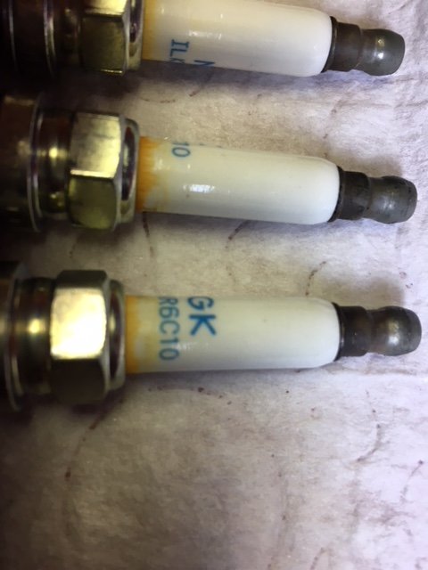

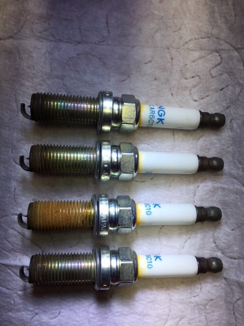

Once you get the knack for it it is not too bad to swap (2 hours?) although it is always good advice to take your time and not panic.Access to many different tools helps (extensions etc). These are 160k km plugs (100k miles)
One was rusty for some reason.

Well it looks like these could have made 200k kms so I don't know how much life you need lol. How did you measure spark differences between the NGK and the denso?
