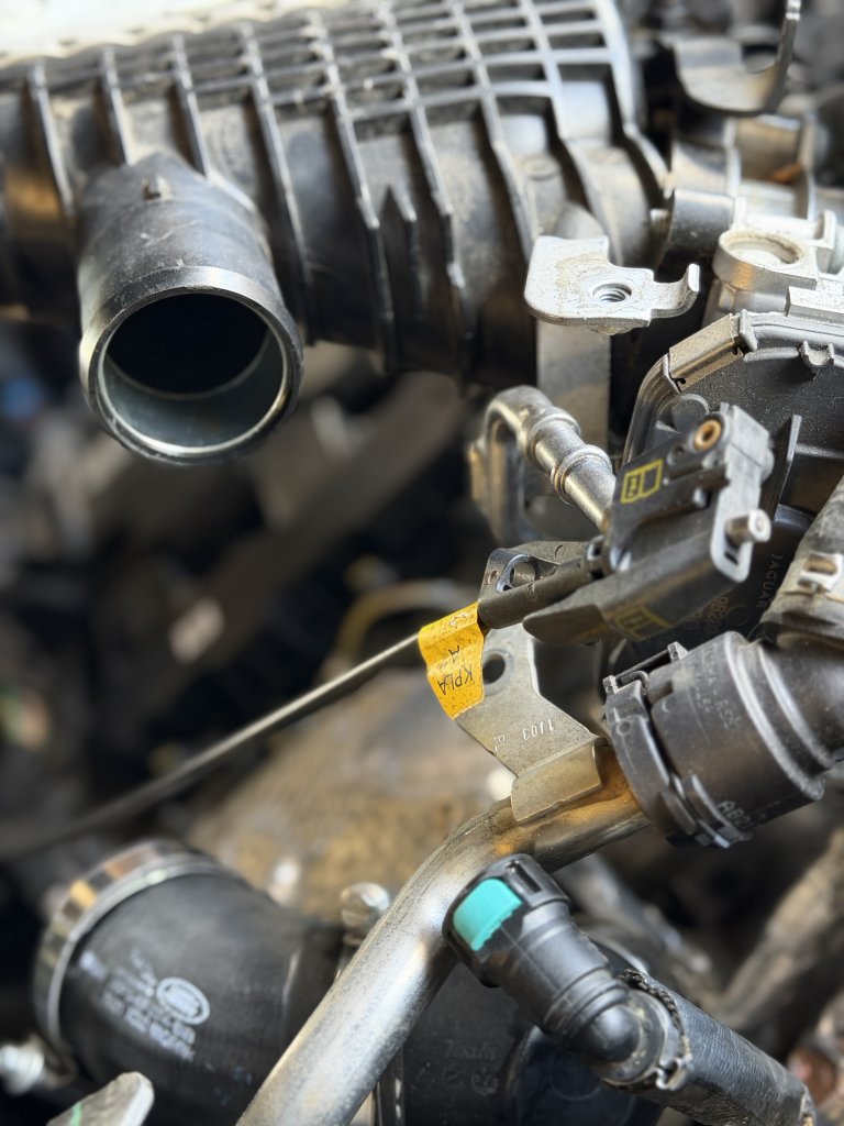

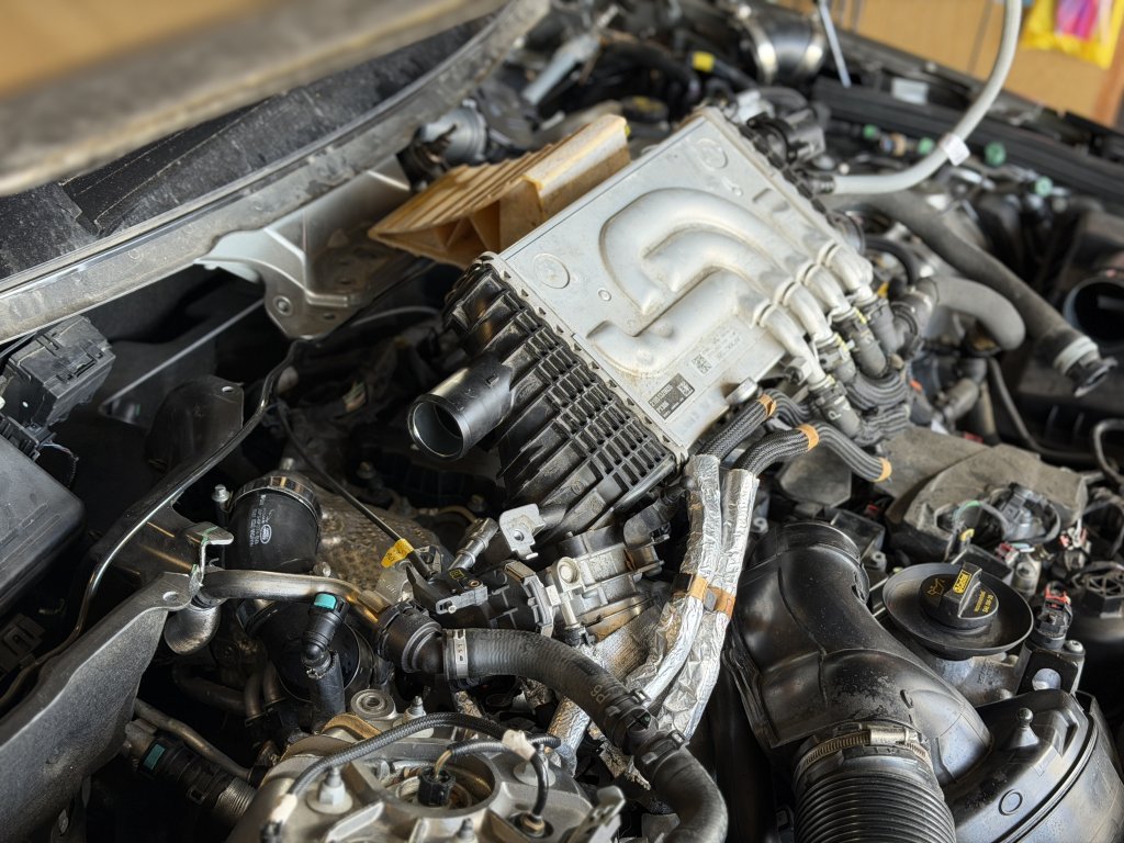

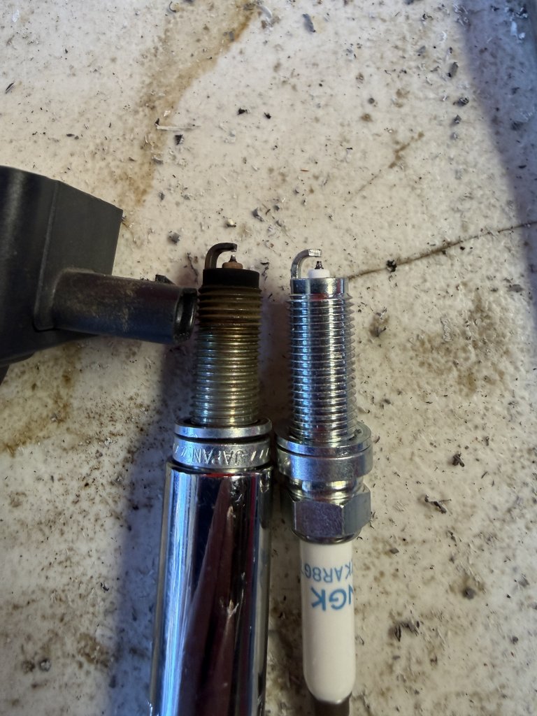

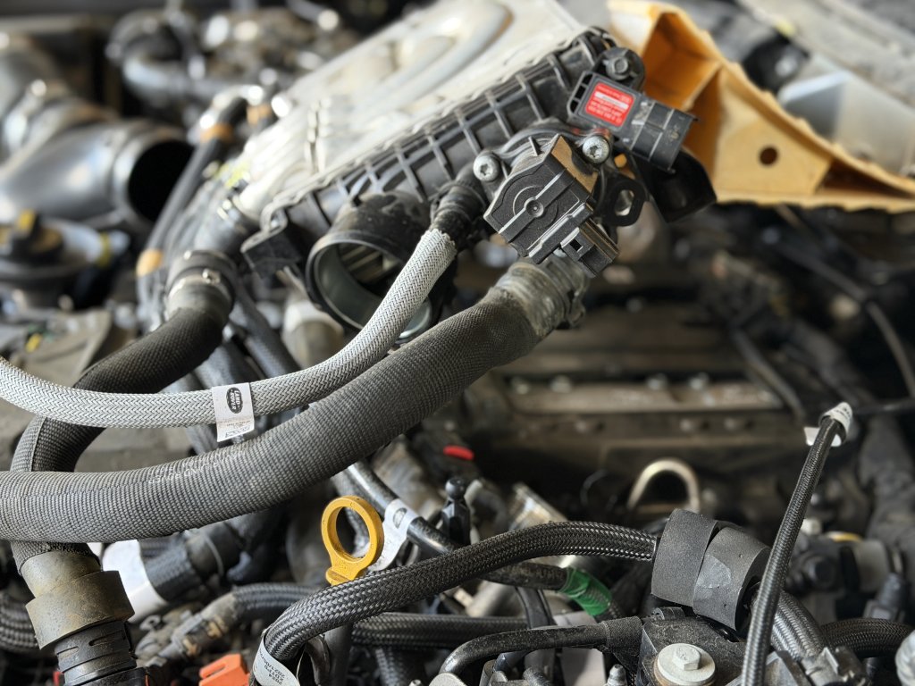

Complete!
Yes, it is almost exactly the same as video, but a bit easier. (Thanks for sharing video... I assumed it would be same as P400, but was hoping it was somehow going to be less work. A little less, but not much.)
- Don't need to remove the hood on Disco
- Wiper arms just popped right of on my vehicle, no puller needed
- No special tools - regular 14mm spark plug socket worked
- OEM NGK were available in 1 hour at local parts store
- Work the Driver side of air cooler out first, then the Passenger
- The Passenger side line with blue tab had to come off and leaked coolant, but not much
Difficult job... took most of a day working slowly.
