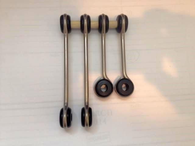

Can someone point me in the right direction to purchase the sasquatch rods?
It's handy...
Wow! This really seems like the way to go vs. rods. I no longer see any advantage to a rod lift vs. this controller besides price. The little extra cost seems worth it compared to crawling around under the fender wells!
Only advantage I see is peace of mind or confidence in having a hardware solution installed. That said, I bought GAP Diagnostic's higher-end IIDTool which includes the functionality of the EAS Controller. I plan to continue using the rods but keeping the GAP tool with me at all times for any field repairs or otherwise, when it might be handy. I also feel like the more I screw around with the computers the more I take a chance of hosing something up.
As for the crawling around under the fender wells...it took me an honest 10 minutes last time I swapped the rods out. 12 minutes if you include the time to grab my jackstand and automotive ramps (I like to back the LR3 up onto the ramps to gain clearance, then throw the jackstand(s) underneath for safety).
With my pattern of driving now, I can get away with swapping the rods about twice a year.
