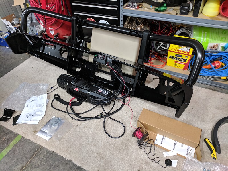

For those of you that have installed the ARB Deluxe bumper, what should I be aware of when picking a winch?
It’s a big truck so obviously a good capacity, and I’ve become a big fan of synthetic lines.
Advice?

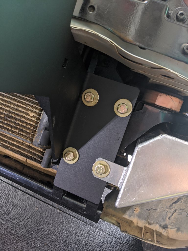

I agree with @NASdiesel . I just slapped a 12k zeon platinum on mine but it was a T44 front bumper. Only thing I would suggest is changing the hardware to 1/2" grade 8. Once you remove that front bumper you will see that the 8 bolts that you use to connect the winch tray to the frame are 8mm, or something along those lines. I ended up drilling those threads out put the beefier hardware on...probably overkill, but makes me feel better about it. You can see the comparison below between the two.

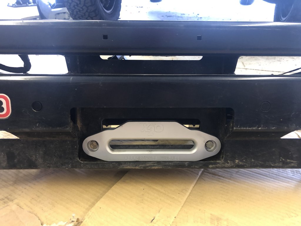

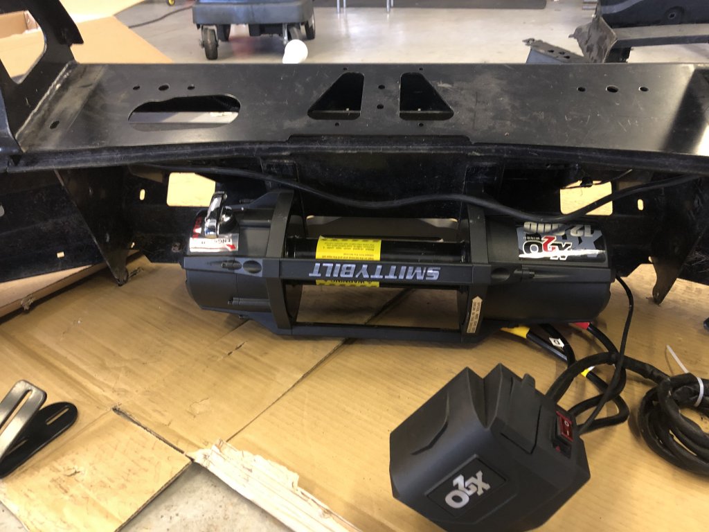

So I ended up with a Smittybilt winch. We are having some issues trying to fit it. Anyone used this setup and could give me some hints?
