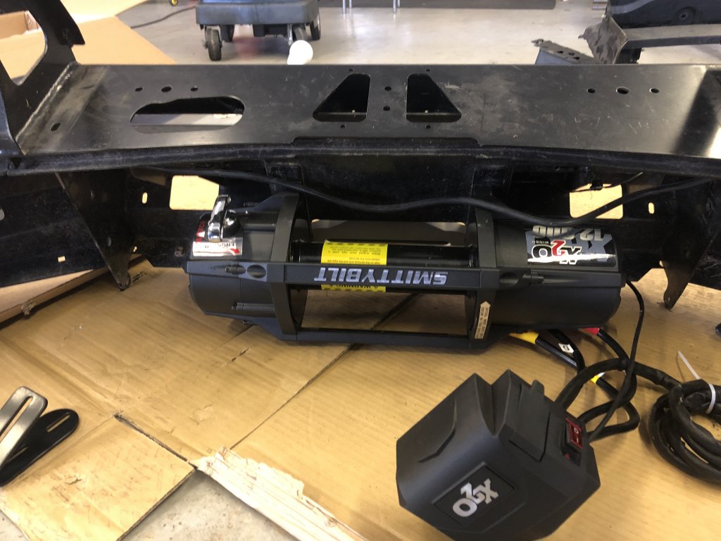

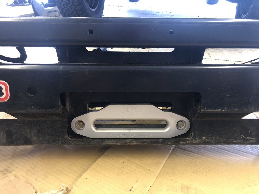

So I ended up with a Smittybilt winch. We are having some issues trying to fit it. Anyone used this setup and could give me some hints?
where are you having trouble? You may need to clock either the motor or clutch or both to make it fit how you want in the bumper. From the factory they usually come set up for a “feet down” install so need some adjustment for a “feet forward” install.
