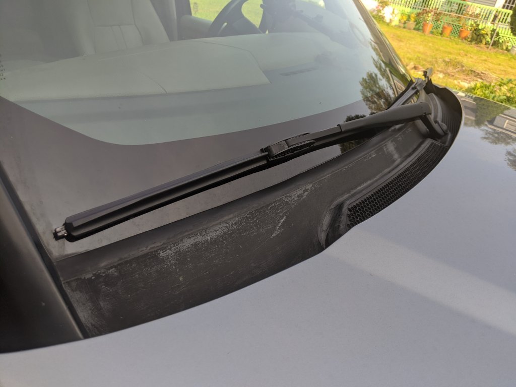

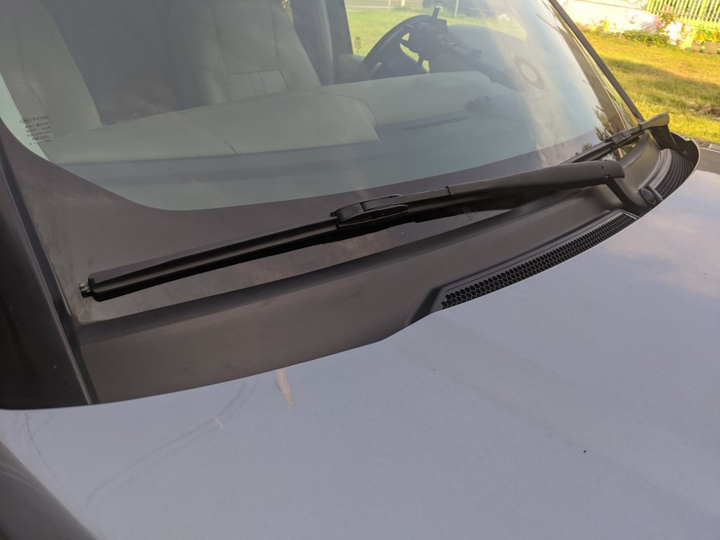

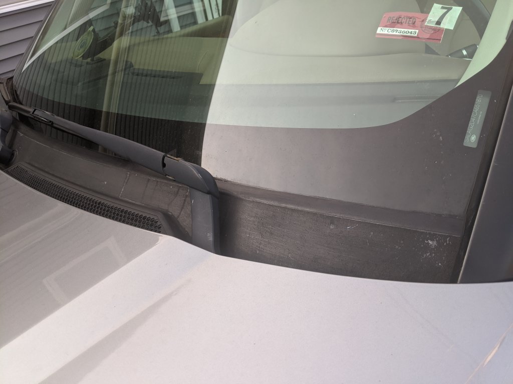

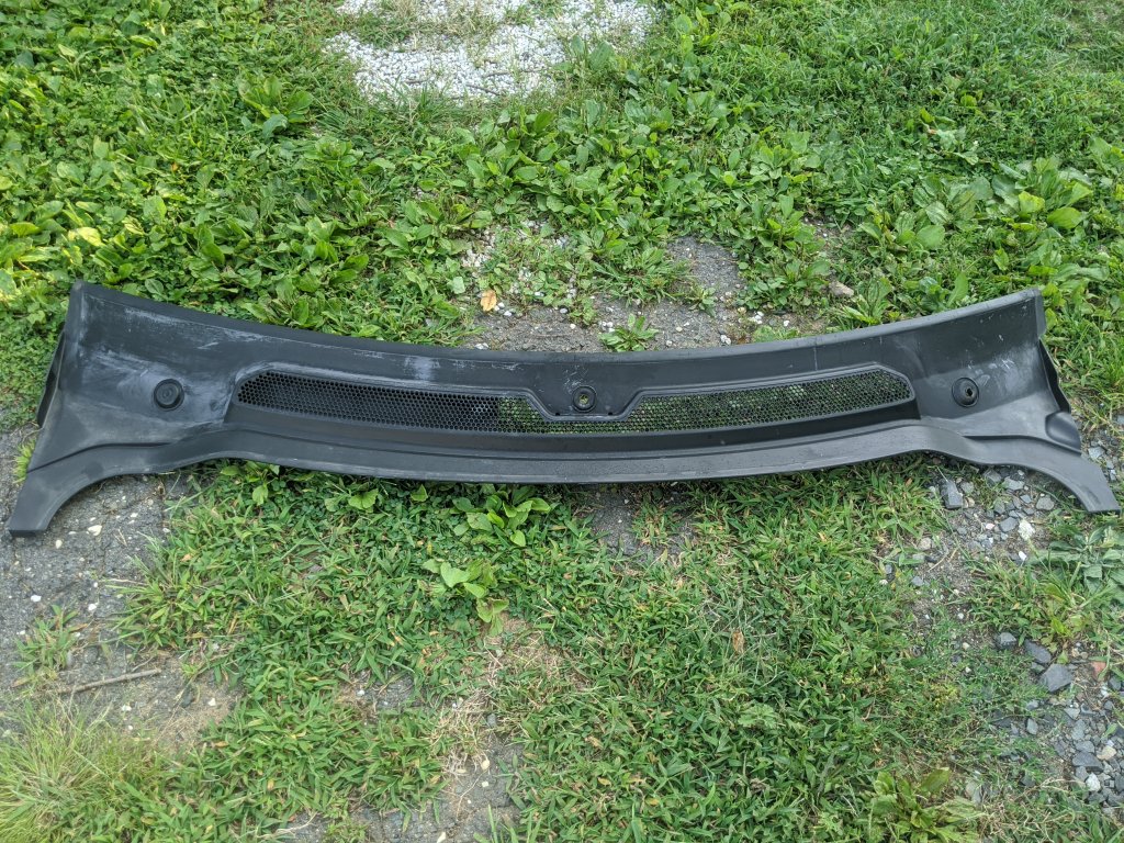

My 2012's was sun-damaged and tried that Forever Black stuff but it ended up washing off in a month. Grabbed the part for about $80 + shipping and found this vid
(LR3 apparently has the same part). Right wiper arm was seized to the post but some WD-40 rust release, 10 minute wait and a rubber mallet did the trick.
