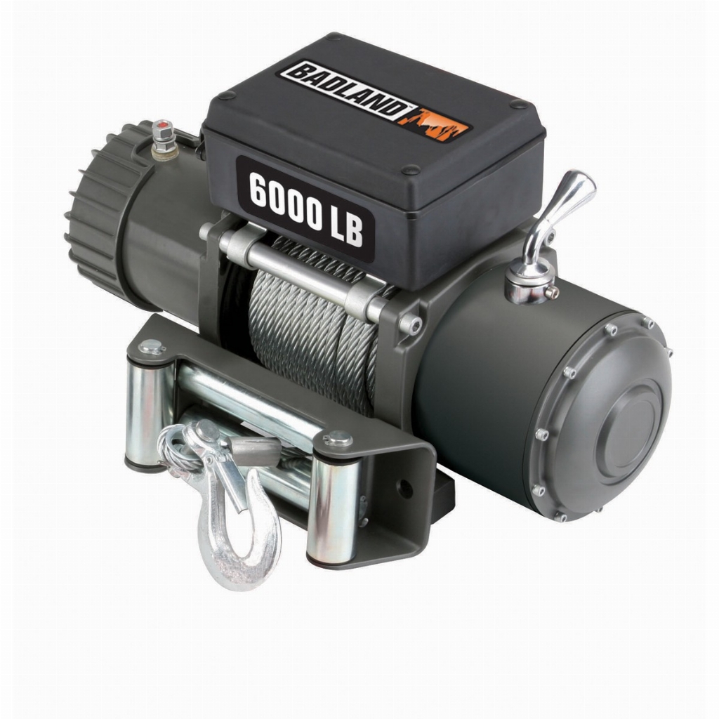

I have been looking for some winches to install on my LR3, saw this one but wasn't sure if this will work:
http://www.harborfreight.com/6000-l...-with-automatic-load-holding-brake-68141.html
Anyone done this or interested?

6000 lbs isn't enough for an LR3....you want one rated at 9000 or more...though you "can" get by with one rated at 8000, but why risk it.
Also, when purchasing a winch, invest in a good one. That Harbor Freight one above is a made in china cheap POS

Which one do you recommend that is optimal and fits LR3?

Warn XD9000 or for a little extra money the Warn 9.5 XP. the 9.5 XP is the same one LR sells for their winch setup. I opted for the 9.5 XP on my arb front bumper

If you're looking to save some money you could go with a Smittybilt XRC10 or 12. I have had a XRC8 on my Jeep for a few years and have had no problems.

I've got the XD9000. It seems like figuring out how you plan on mounting it, and powering it are equally important questions. In the end, the winch is a small part of it, albeit an important one.
You can consider winch trays, winch bumpers and so on. Consider ringing up Justin @ lucky8 and having a talk with him and get some recommendations.

I would suggest you buy your bumper/mount, whatever first so that you will know what will fit.
A 9000 pound plus is really what you need to find, and here again the type of wheeling you do will also play a big factor in which brand to buy.
That winch that you asked about is a piece of very low quality junk.
I run a 9500 HSI Warn winch, which was one of the best built models they ever made, unfortunately they don't make them any more and offer a couple cheaper quality units in it's place.
