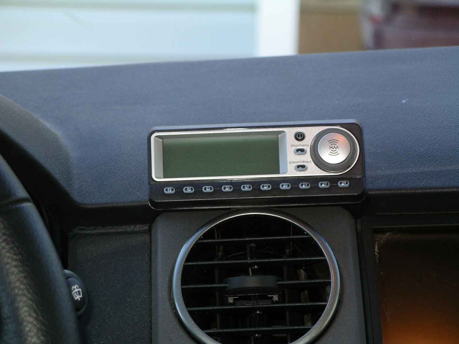

I've got an XM Commander from XM Satalitte Radio. The installers were able to put it in without drilling any holes and the antenna seems about perfect.
One REALLY important point is that many of the wires on this vehicle have a dual function (power and signal). My installer tied into one of these and the computer went totally nuts. The truck was on a transport back to the dealer when the oil light came on from the screwy signals. The shop foreman at the dealer said the only safe place to get power is to go to the battery.
David

A local Dealer here in Atlanta installed XM radio in a nice clean way. They put the unit (i think it was the Commander as Well - not 100% sure) below the ashtray. It looked like it came from England like that!!! I will look for some photos and post.

Your Commander install looks great. Who installed? and did you consider the new RDS modulator which works directly with stock radio.?
Z
zdas04
Guest
A local (Farmington, NM, USA) stereo shop installed it. The RDS modulator was not an option when I had it done in Feburary. If I had it to do today, I'd sure look into that since I don't have any of the on-steering-wheel functions with XM that I have with FM or CD except volume.
