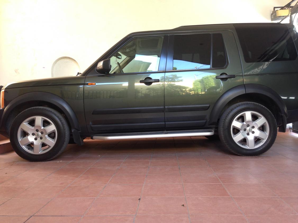

I also suspect the indie calibration is well off, as the rear inflates a load higher:
That's normal. The rear is supposed to be higher than the front. The measurement from the center of each wheel to the underside of the wheel arch should be 466mm for each front wheel and 485mm for each rear wheel.

yah I know but one can easily tell that in mine, the difference between front and rear is far more than 19 mm, it's almost an inch and half...
anyhow I'll measure it as soon as I have time. :S

I thought it was off, but measurements kinda match what cmb6s said, except the difference between front and rear is around 40 mm instead of 20...#

So I woke up this morning and went straight to measure it, the results:
Same height rear and a loss of about 35 mm in both front struts, this comes as a surprise as before the compressor swap the rear was the one giving trouble.
what does this mean? is this a new unrelated problem??
