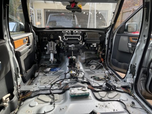

I’m turning as fast as I can! Although admittedly, it’s turning wires. This is the inside of my 2010. At least I’ve got the antennas swapped and the headliner recovered and installed. I just finished tracing all the different dash pinouts, and now I’m splicing the new radio/amp harness in. Hopefully by Friday or early next week I’ll be testing the “new Bosch” infotainment in my 2010. Once I do that, the. Swap some brake hoses out, it’ll be time for the SC swap. Cause again…I’m under the gun time wise and can’t ship a non-running vehicle…so success must be achieved at ALL costs! (Kinda like this infotainment swap). I’m too far into it…if it doesn’t work, my wife is gonna **** me for screwing her car up!! Not to mention a radio is kinda nice.
