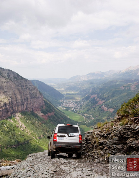

Yeap, I've seen that too in a friend's HSE up on Black Bear Pass:

I have an '05 LR3 HSE and I noticed that with Nathan on Black Bear (the pic above) at last years LRNR. The only solution is to swith the display over to Metric. That way you will have readings in metres and I doubt you will be heading above 9999 metres (30,000 feet). It is in the setup menu that you access by pushing the button on the end of the turn signal arm.
