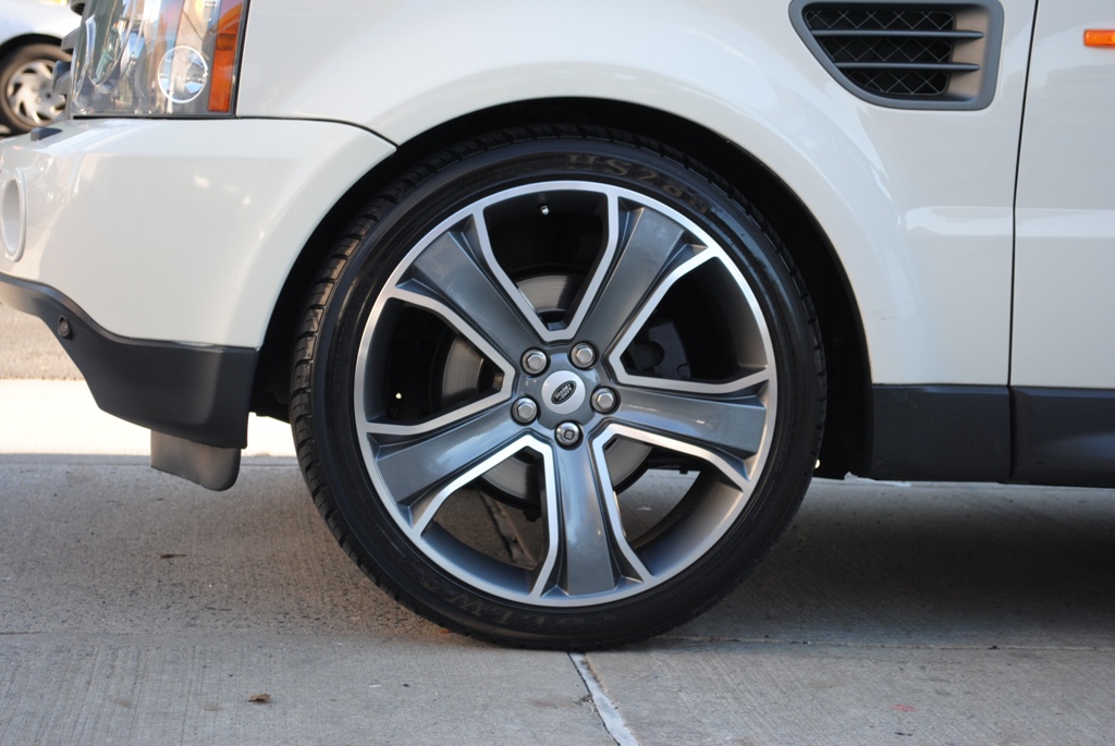

So im thinking of investing on some new rims on my Land Rover LR3 HSE it has the original 19 inch my question was if i upgrade and put 20 inch would it affect the air suspension in any way of adjusting the drive on the vehicle... im thinking of putting range rover sport rims size 20 these are the pics.

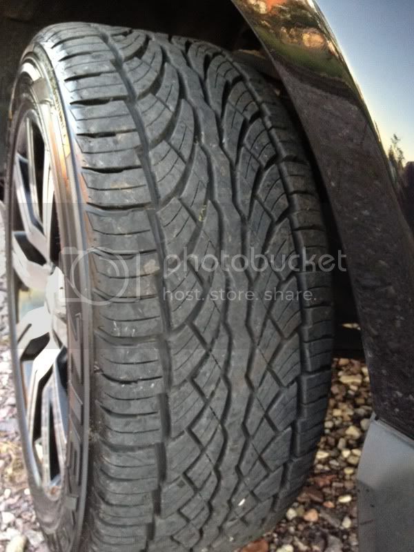

You may notice a slightly harsher ride. Make sure the wheels are properly weight rated - above 940kg per wheel if you're in the USA. Also the tires must be rated 111 or higher. I recently put new 20" wheels and tires on my LR3, I settled on 265/50/20 111 tires which are about 1% larger than 19" stock. I am happy with my decision.

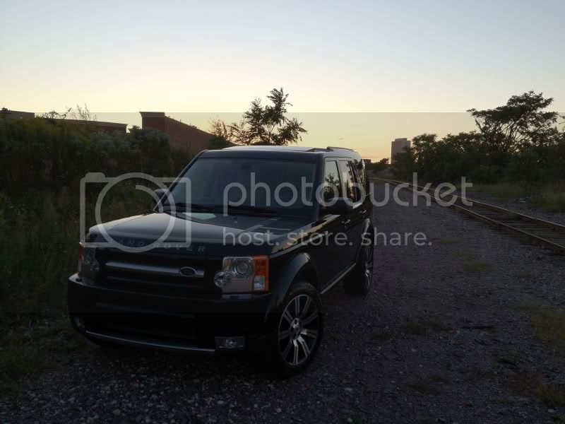

I put 20" machined stormer wheels with gloss black and Falken ZIEX S/TZ04 in 265/50/20 size. I purchased the set of wheels from a dealer in California, they have a weight rating of 1050kg per wheel which is above the required 940kg per wheel. I actually had purchased two (2) sets of wheels from sellers that promised that the weight rating was above 940kg only to arrive at 700kg. The Falken tires so far are great, they are a major improvement over my goodyear wranglers and were very inexpensive.

Your LR3 looks really nice with those wheels...... i still havent purchased mine yet i was actually debating on the ones you have on yours but in gun metal finish....another question the size 22 it is pretty big for these kind of vehicles what do u think...

22" is too big in my opinion, and the ride quality really drops. The tires I chose have 14mm of tread depth and it's actually a smoother ride now than what I had on my 19"s. We'll see if that holds true in a few months. The wheels I chose are 20 x 9.5 with 45eta offset. This combination sticks out 1.06" further. I was worried it wouldn't look right, but it looks better and I think up to a 40eta offset would be fine. The place I bought my wheels from also sells a machined stormer with gunmetal instead of black. With my D3 being black i wanted the black wheels. If you have a lighter color I bet the machines gunmetal stormer would look good. Pm me if you want the contact info for the place I bought the wheels.
