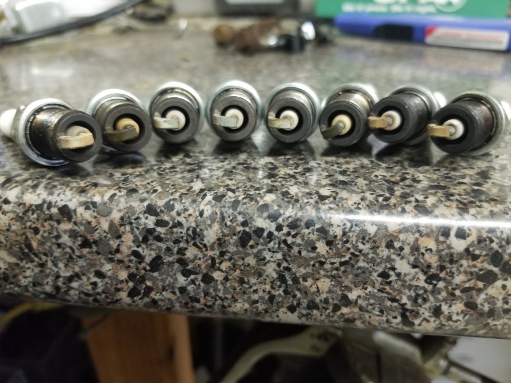

After the codes came up, I inspected and changed the spark plugs. (None of the spark plugs were wet but cylinders 2 & 6 plugs weren't the beige color like the rest but just a darker brown, see pic, plugs are arranged 1-8)
