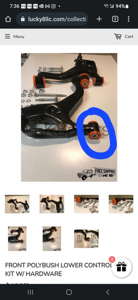

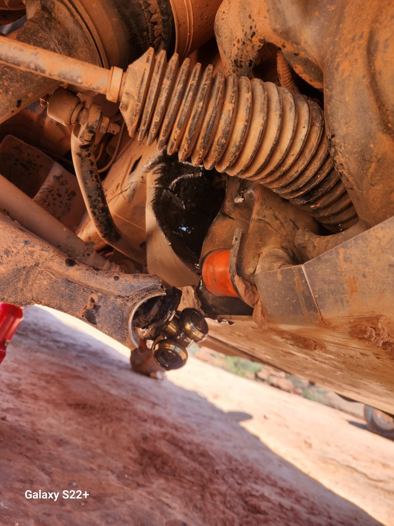

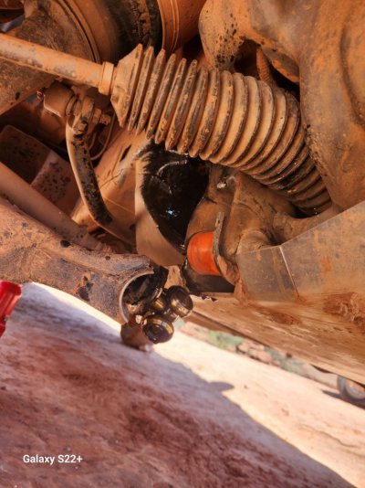

Not true... I've "upgraded" to the Lucky8 hd lower control arms with poly bushings not too long ago. While out on an easy trail the RH LCA broke at the front bushing, the axle popped out of the cv joint on the engine side, and bent the airbag/strut deeming it completely useless. Luckily, I ran my smaller 31" tires that day and the SYA saved my A$$. I couldn't imagine the damage it would have done with my 33s.
And fyi, I've been on bump stops while on the move with my 33s and the SYA kit saved me from causing some damage.
I also have individual schrader valves for each corner as an emergency backup along with the xlifter and gap. So, being overly prepared is a good thing.

I’ll probably come off as an asshole here, but it’s pretty well documented that the poly bush arms will break like that.
**** happens, but I think the “plan for an inevitable air suspension failure” thing is outdated.
I guess I'm old school then.
Really? It's the first I've heard of it.
While out on an easy trail the RH LCA broke at the front bushing...
What is the failure mode? Did the bolt break? The LCA itself sheared?
It's actually pretty common, but I thought I'm special and it wouldn't happen to me.
It broke where the bushing inserts into the front LCA. The bushing was 100% in tact, the LCA bushing hoop broke in half where it meets the the rest of the welded structure.

What is LK8 saying? Gotta be a parts defect. Junk metal they are stamped from?

Is it because there's no compliance in the poly bushing, so what would normally be ramps in force turn into impacts/step functions? Are there any stress fractures on the other side? Scary! Another reason to regret installing the poly to add to my list.
